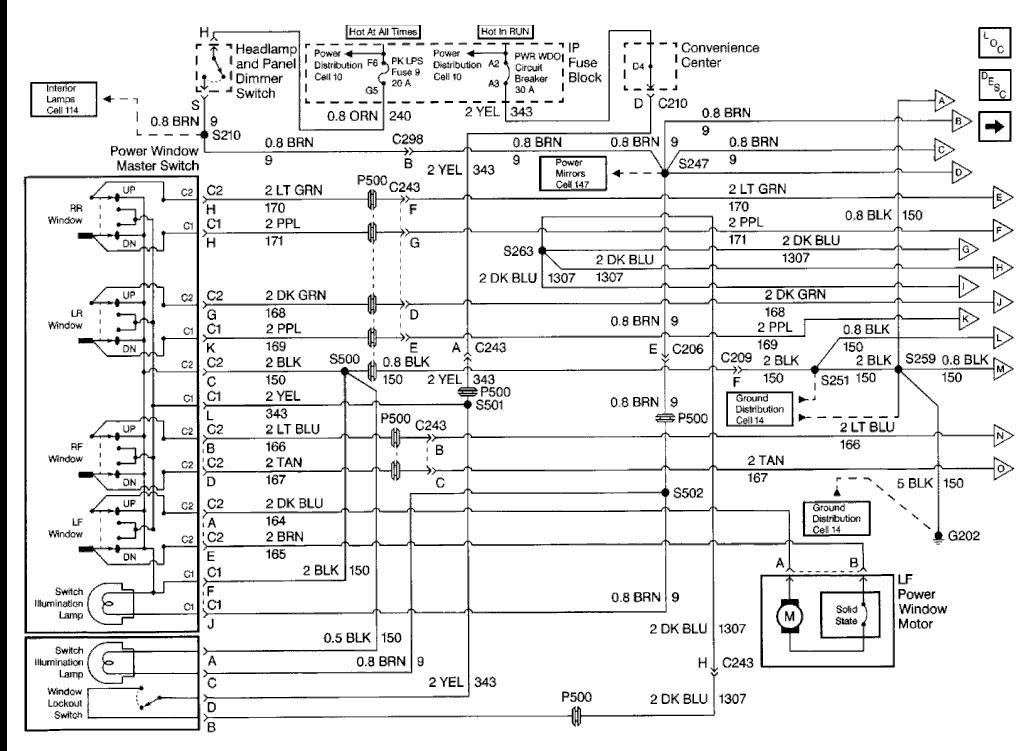

    The power to the windows and radio goes through the ignition switch and to the fuse panel, so if the switch isn't the issue, then I'd guess you have something feeding power to that circuit. Check the brown wire (circuit #4) between the ignition switch and the fuse panel. There's a splice there (#201), and since the windows and radio are working regardless of ignition position, it must be getting voltage upstream of that on the ignition switch side. That splice is in the steering column somewhere.

    Thanks for the info and the diagram. I'll have to check all of this when the truck gets back, it just left for Vermont. A friend borrowed it for a week. Once again, thank you for the help, I will keep you updated.

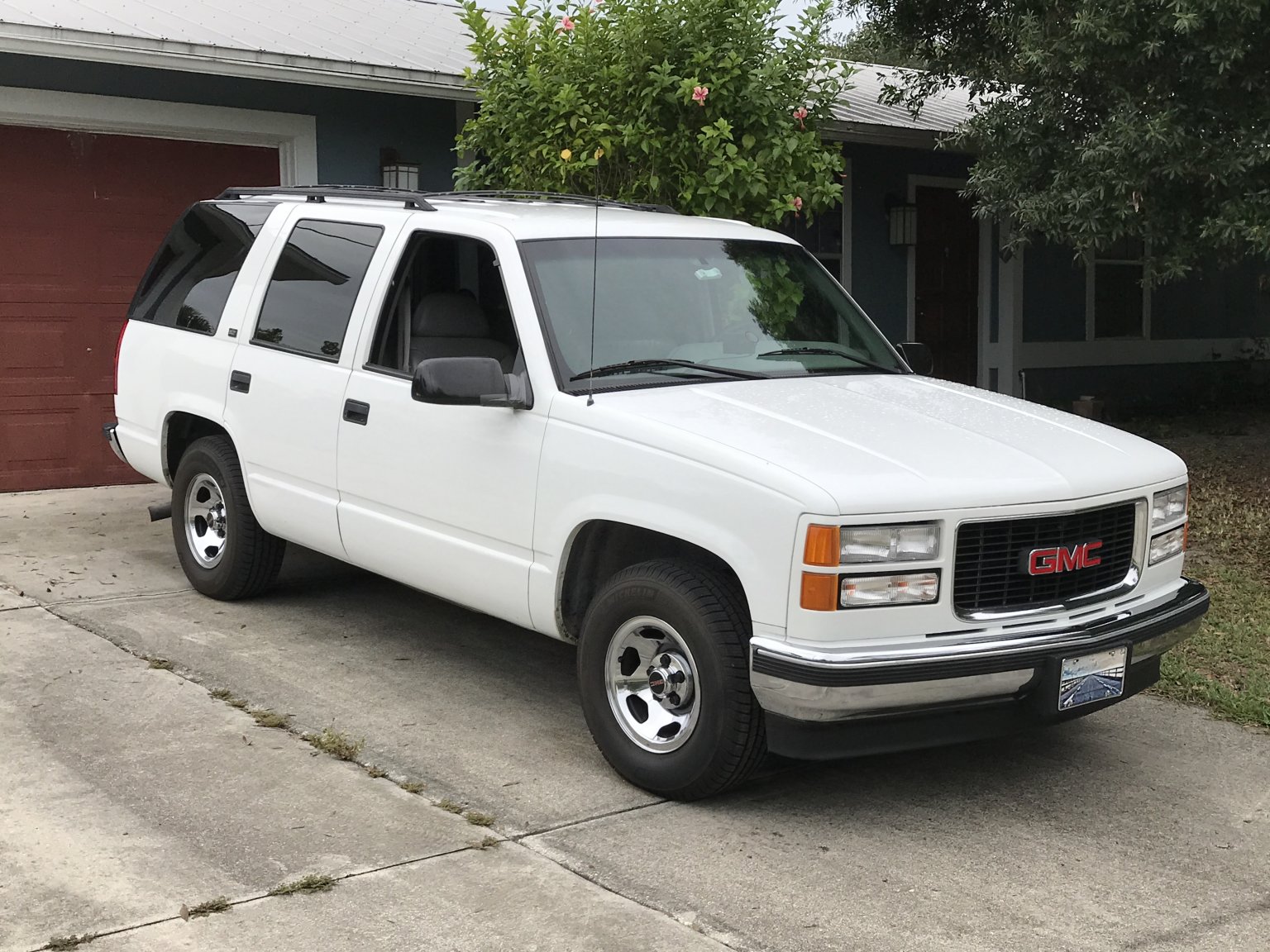

    Thank you all for the responses. I let some friends borrow the Yukon for a road trip, told them to turn off the radio when they got out and drive it every day to keep it charged. On about day three of their trip the problem went away. They said They noticed the radio went off with the key and everything was working as it should. So I guess it healed up?? Ghost in the machine IMG_3170.JPG
