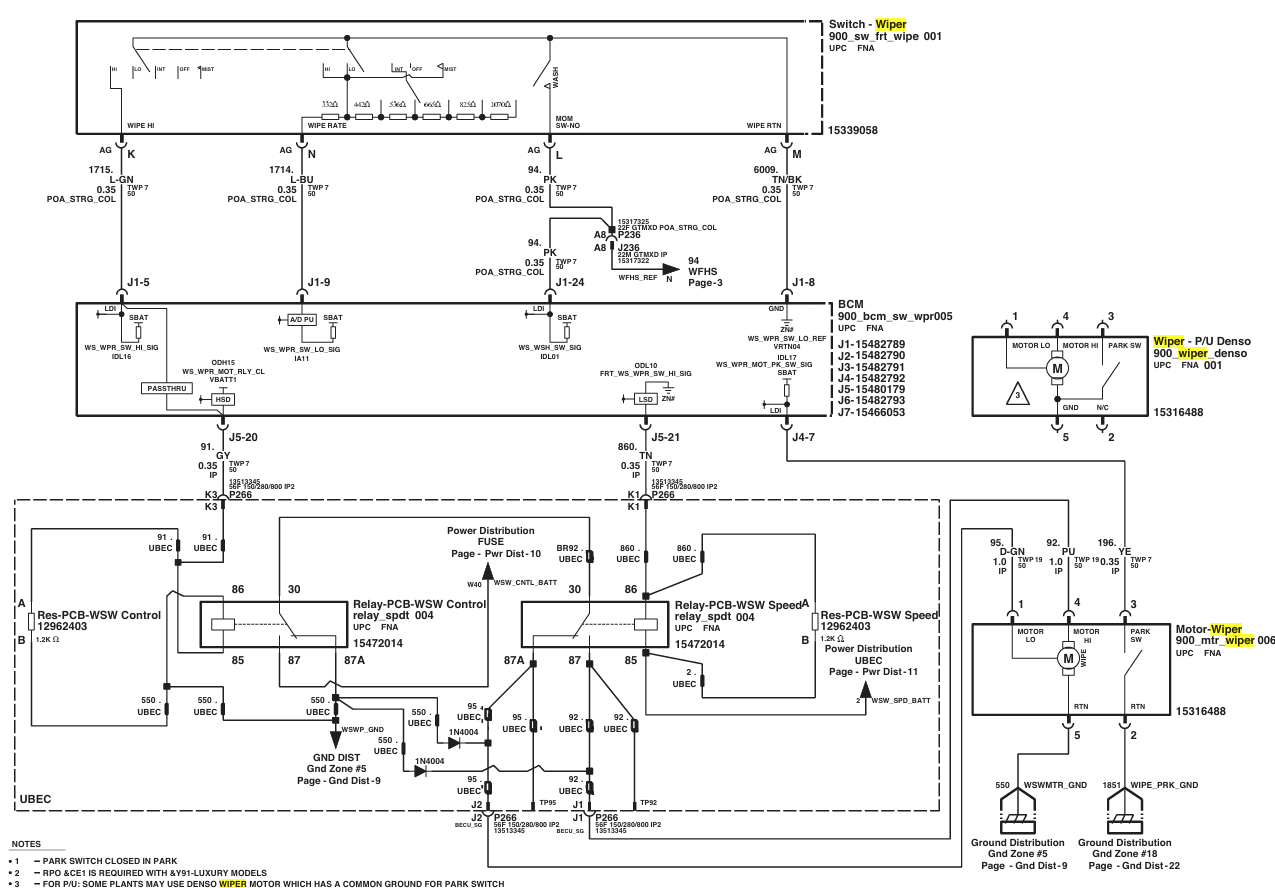

Looking at the wiring diagram, the relays look to be integrated onto the pcboard in the underhood fusebox..

Everytime I look at it, it's more complicated than I want it to be!
I see a black wire for the ground... but no red wire?
Hopefully OP won't need a new fusebox, that seems to have been happening for various reasons..

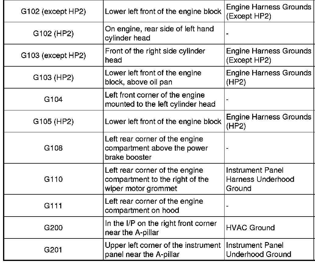

Might try jumpering the grounds to a separate ground, or check those two grounds.. (G201 is under the dash defroster panel)
