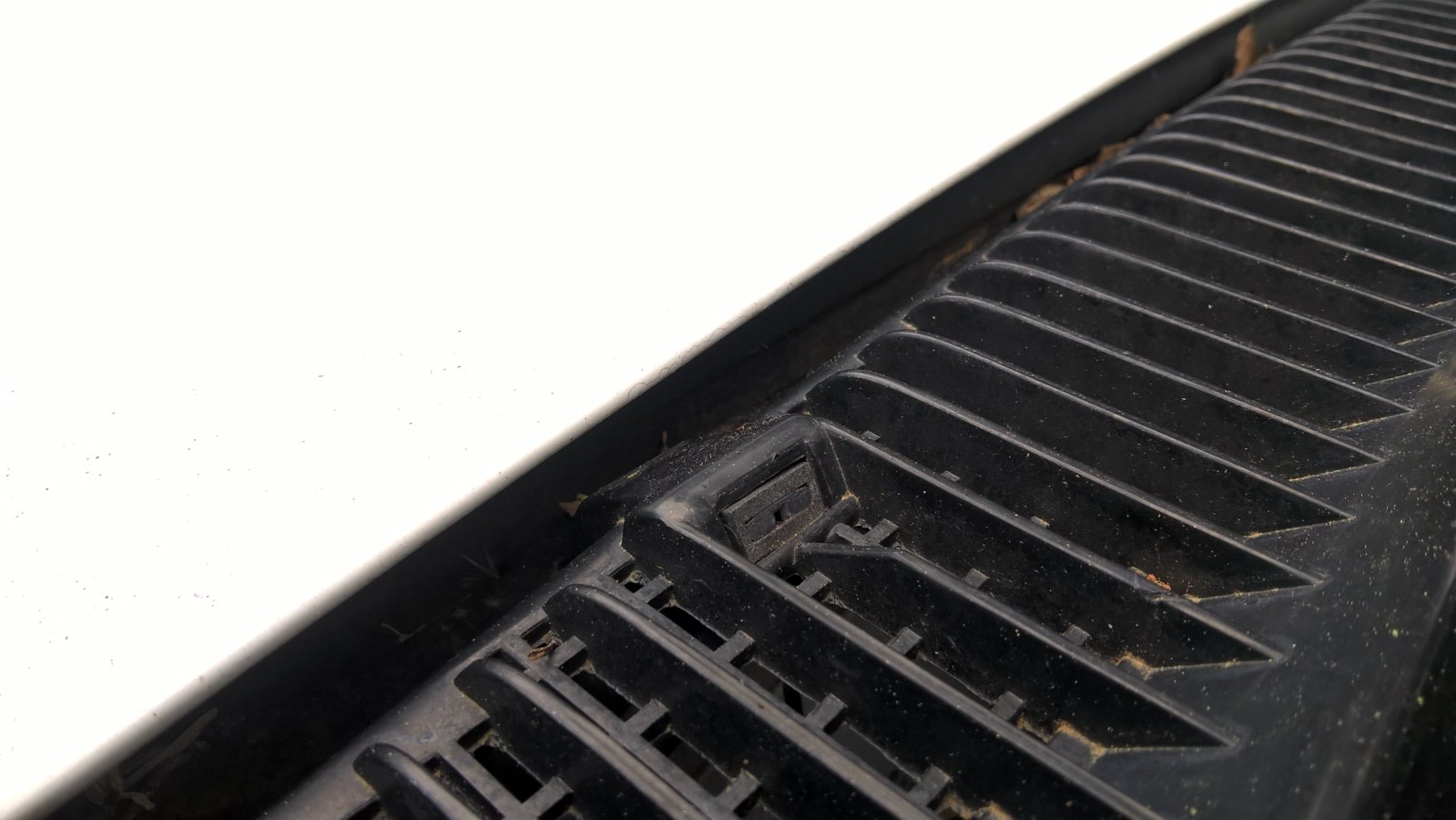

Here is the nozzle...
Same as I had on the others
(current, 94 K2500 pickup)
(others, 93 K1500 Sub, 94 K1500 pickup & tahoe)

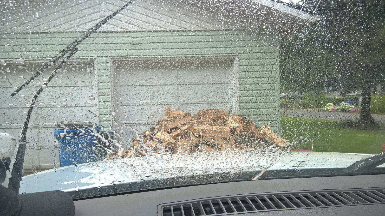

Here is my field of view...
When the spray begins, the wiper comes on... basically its wiped off on the 1st downward stroke of the wiper and it never sprays high enough to get above the wipers... therefore, windshield never really gets cleaned.
you can see that the spray never shoots higher than the line of the hood, the wiper in this picture is lifted away from the glass.

Those don't look adjustable/aimable. Can they be popped out, flipped and reinserted? That may actually aim them lower. You'd have to look at them from the side while someone pulls the lever.
Kelsda
Sep 16, 2017
280
226
New Jersey
Plastic wheel inside wears out get new ones they only go in one way
