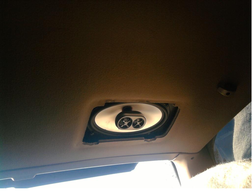

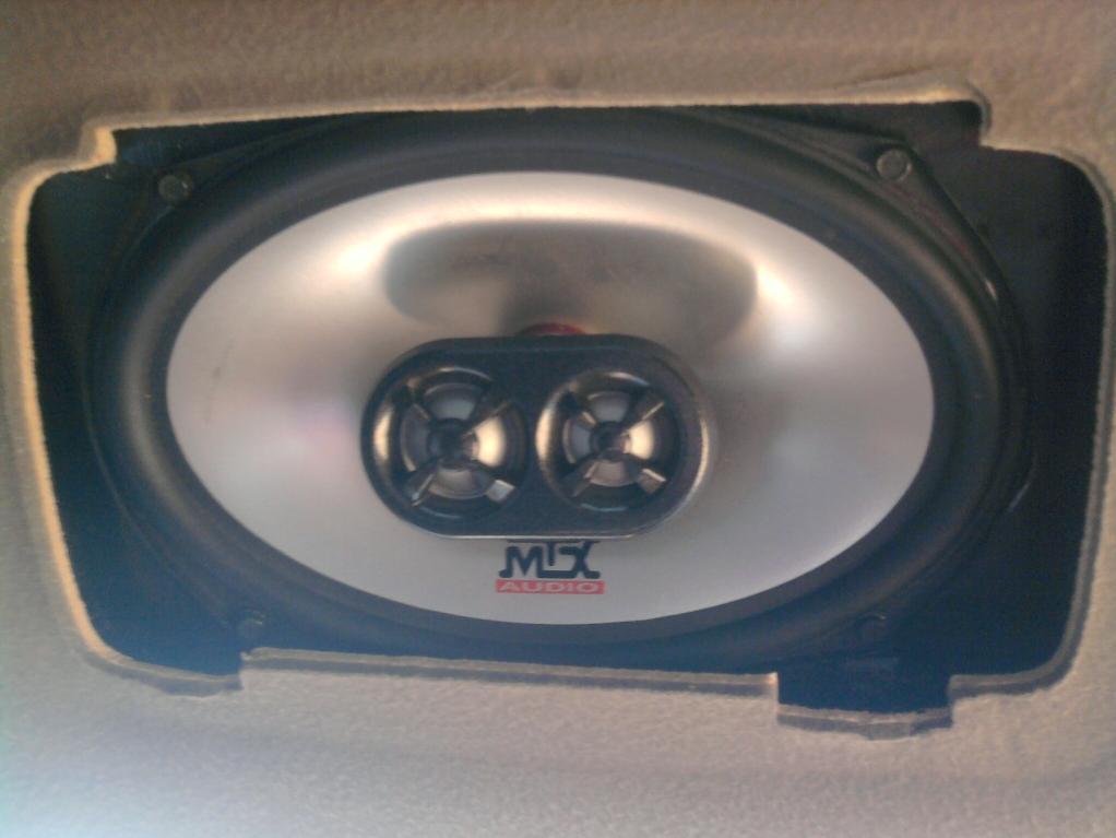

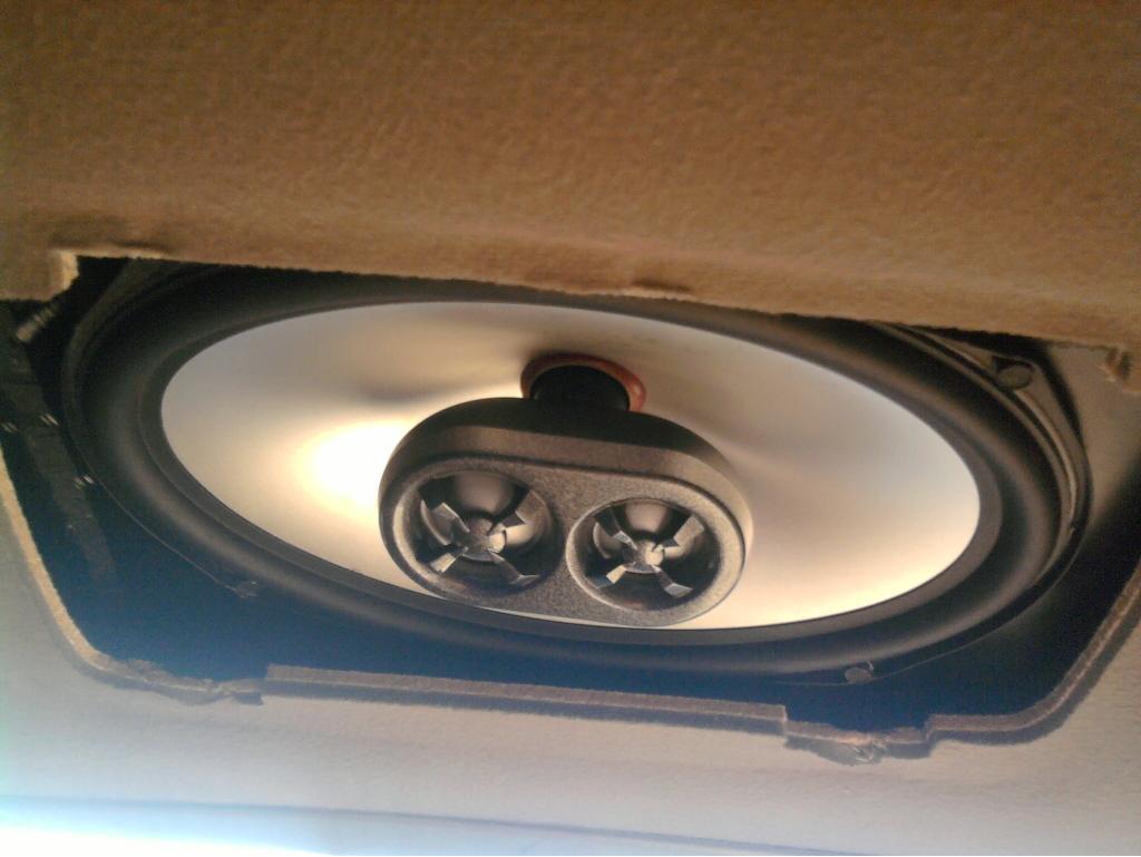

Will 5x7s fit
cpv2door
Jun 29, 2010
Whidbey Island, Washington
pix..

That looks like it fits well, can you still get the factory screens over them? I would like it to as stock as possible.

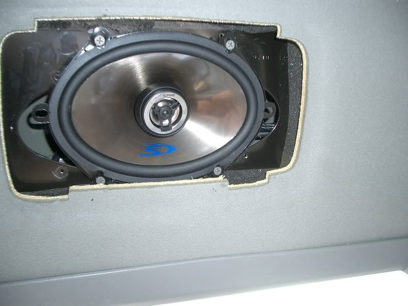

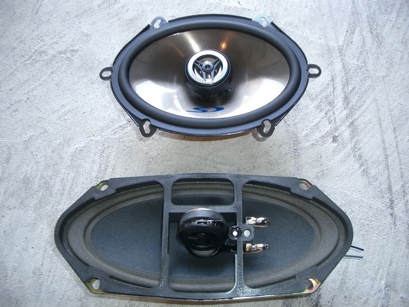

here's my swap from the OEM sizes on my last tahoe:
OEM
Comparison:
Tracing the cutout area
Fitted:
Ideally, you'd want to make a speaker plate from 1/4" MDF or plywood sheet to fill in the gaps and possibly throw down some dynamat as well.

for sure, you don't want opening like this, you'll want to seperate the front and rear
