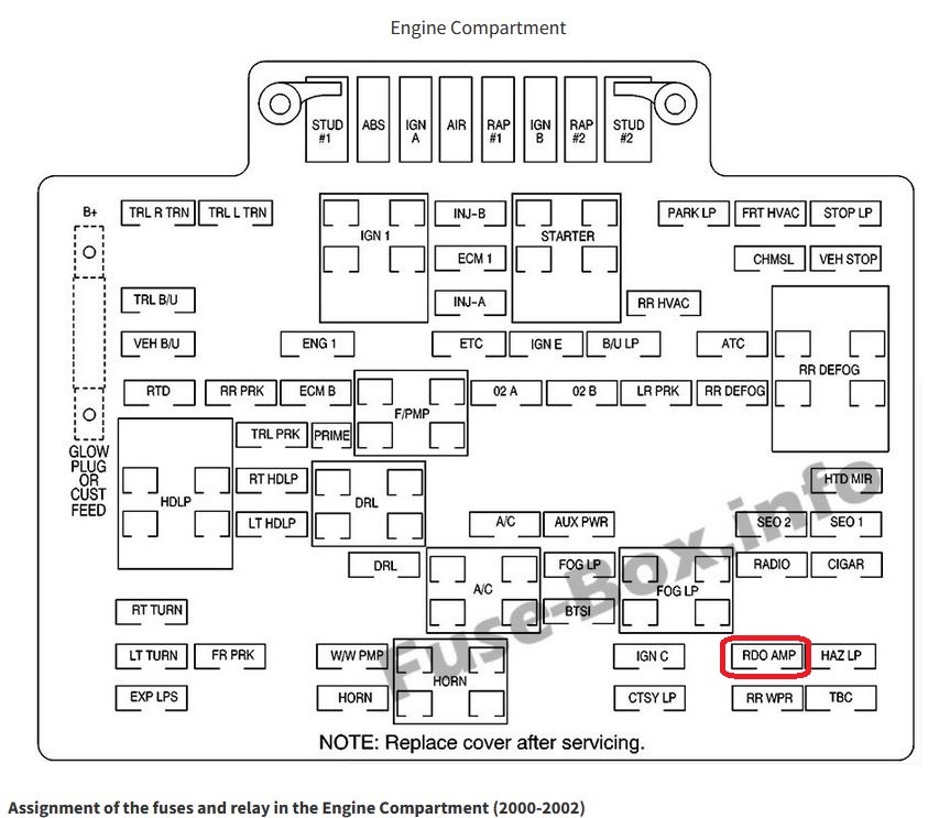

That underhood fuse diagram is for 2003-2006. Close but no cigar. Fuses are different for 2000-2002:

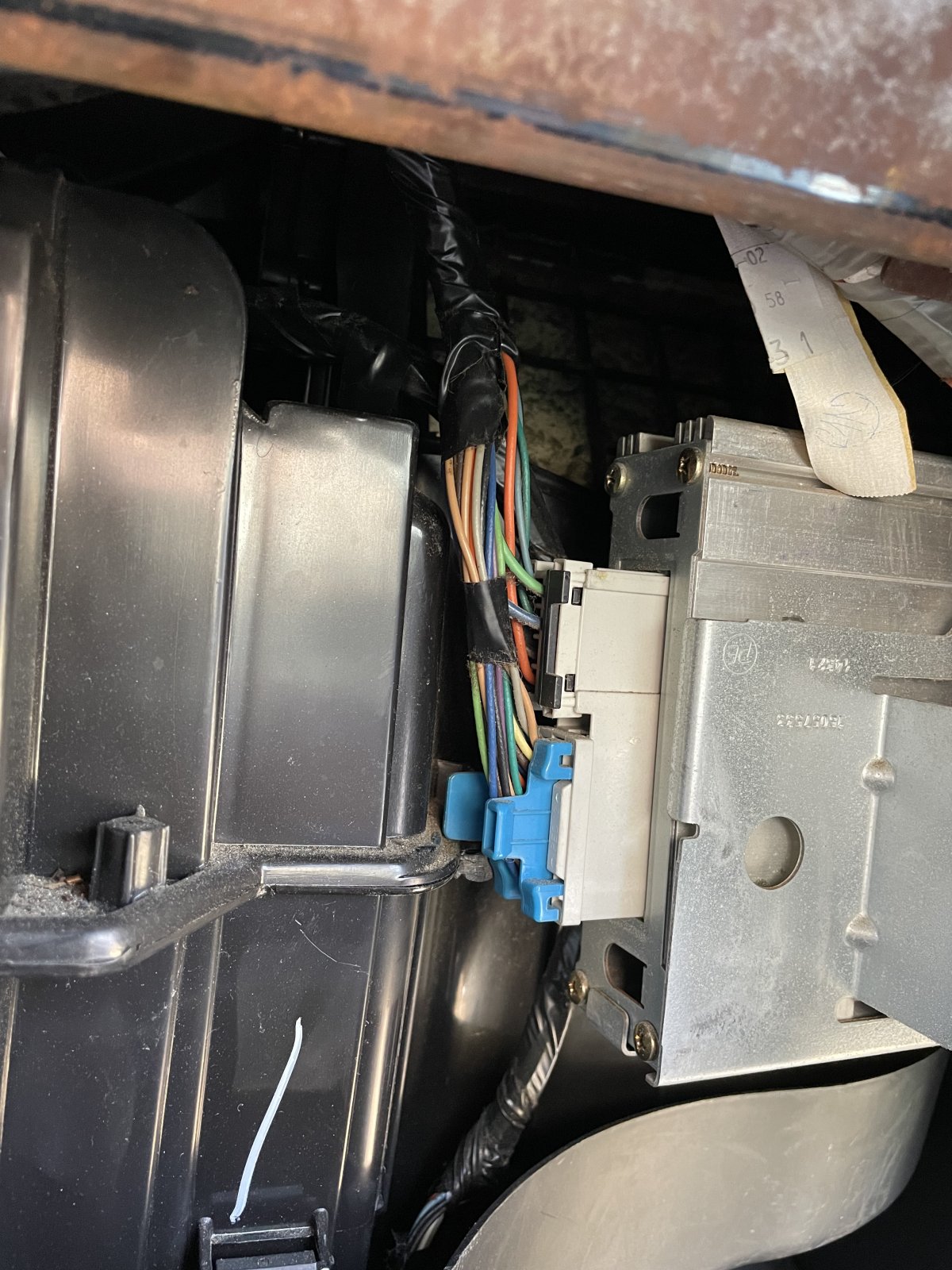

So here is the amp, radio and the big hole i made in the dash. Still can't find the stinkin amp harness. Would it be coming from the right hand side from behind the glovebox door? both of those harnesses off the amp go into a much larger tape wrapped loom. the 20 amp fuse under the hood is good. i got the fuse diagram off this forum.
The radio and amp harness are integrated into the main harness, there is no separate harness
if you are simply trying to bypass the factory amp then you will need to connect your aftermarket output to the amp outputs and unplug the factory amp.

ok so the radio shows 2 plugs but I can't remember how many i disconnected when I took out the OE head unit. I DO NOT want to bypass anything, the rear door speakers aren't working. I initially bought a Metra 70-1858 and the rear door speakers aren't working. I called Metra and they said I need a 70-1859 cuz we have 7 speakers. I sent Metra a pic of the OE head unit and they said i have a second plug for the amp. The 70.1859 has two plugs (the main plug is the same as the 1858 but has a second plug) and one plug has a single red wire on it for the amp. I plugged the OE unit back in using the single OE harness and the rear door speakers don't work either. Thank you for the updated fuse diagram, just pulled that fuse (25 amp) and it looks good. I swapped it with the other 25 amp fuse for the wipers.)
Are we absolutely sure there is only a single harness for this OE head unit?
I called my local dealer and the parts guys confirmed it has the enhanced audio but i did not ask how many harnesses it used.
Could I have a bad amp? What else would cause the rear door speakers not to work. i thought I may have screwed up the Pioneer harness adapter but the OE radio has no rear door speakers as well......
