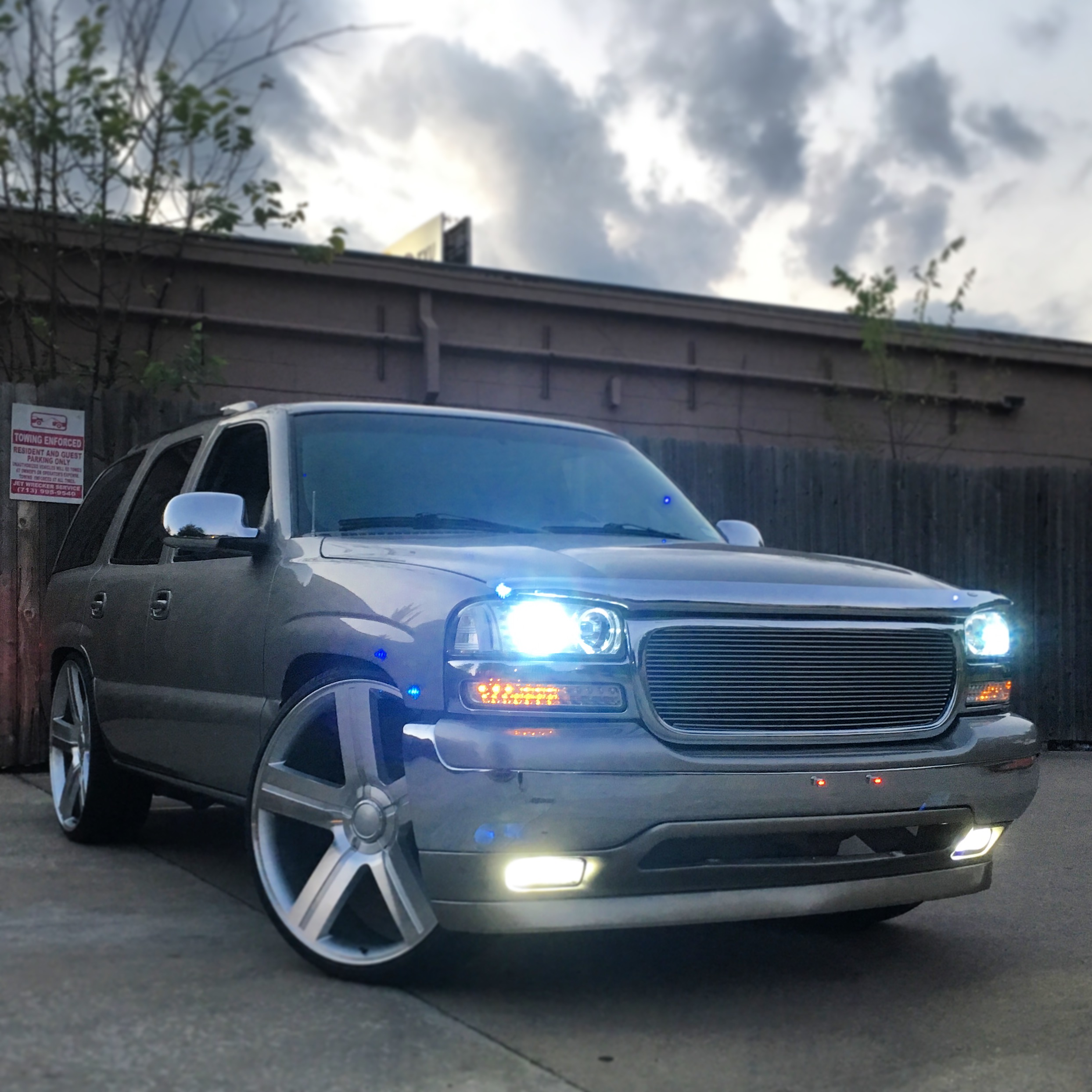

Damn those are fooking skinny but the reps look sweet with that stance. Niiice...

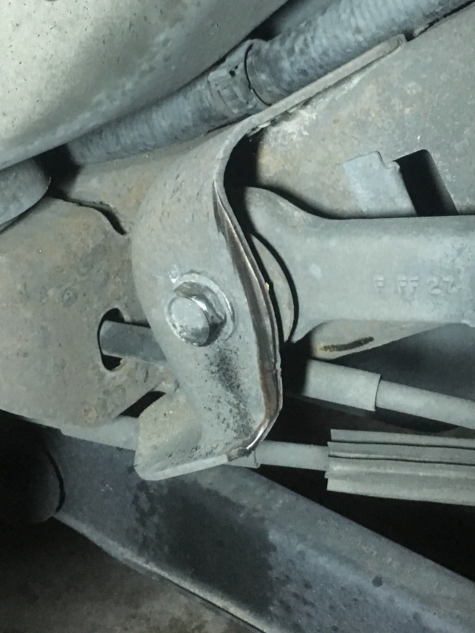

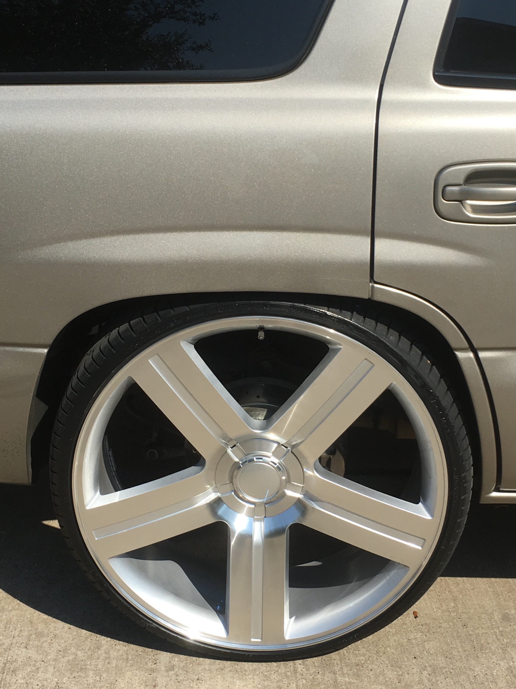

They have 295-25-28 tires. They guys at the tire shop didn't think they fit. It rubs on hard turns and on rear upper control arm bolt and bracket. For the rear I'm gonna try to order Spohn adjustable lower control arm to push the rear wheels more back and away from the upper control arm rubbing.

It actually rides very smooth for what it is. Tony's dropped springs helped a lot cause my Djm springs were bouncy. Now it's smooth ride, but I do try to swang around pot holes since the tire has like no sidewall lol
