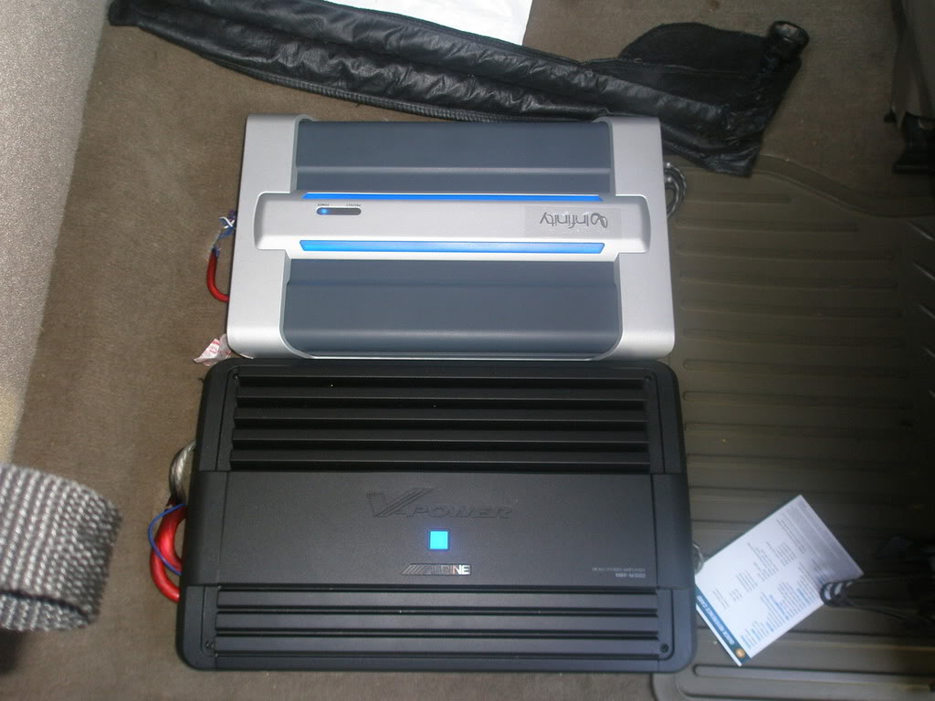

lol, IDK, its an apline cd-105 HU. But I just dont feel the bass any lower than 3/4 power on the amp. Speakers are like 1/4 their setting and they way over power the sub. I have 0 gauge wires for the sub to the battery and the big 3 upgrade.
looking online it says it can handle 1000 watts. So I figured I was ok in putting out that much power. Maybe it is the amp. IDK 1000w is alot I know. I could be def to though. Listening to powertools all day then loud music, then my loud engines. etc lol.
But when I first had the system installed it was great at half, then it seemed to get weaker so I juiced it up. Then it got weaker so I just maxed everything out, Then my Rockford sub blew so I put a JL w7 sub in, that thing made like 5000 million times better bass so I turned everything down again, Then the cycle started all over, It seems to get quieter so I juiced it back up, and so on.

lol, IDK, its an apline cd-105 HU. But I just dont feel the bass any lower. Speakers are like 1/4 their setting and they way over power the sub. I have 0 gauge wires for the sub to the battery and the big 3 upgrade.
You're sub amp bro.. In your sig it says 1000 watt Alpine amp.. Alpine's 1000 watt is the PDX-1.. I ask this to make sure you dont have a 250 or 300 watt Alpine amp that says 1000 watts (peak power) on it.
Go to best buy, or similar store, and you'll see what I'm talking about. They claim 2000 watts!!! but they're like 200 RMS. They overrate the amps. They'll rate them at 1 ohm or even 1/2 ohm at 1 channel (or for a multi channel amp, they'll give you the bridged power rating.. and then divide it by the resistance.)
So.. if you start with 1000 watts at 4 ohms.. then they'll claim 4000 watts at 1 ohm (or start 1000 at 2 ohm, and rate at 2000 at 1/2 ohm)
The w7 is a 3 ohm speaker. The JL 1000/1 is a true 1000 watts over a range of 1.5-4 ohms. The PDX-1 is rated 1000 watts at 1 - 2 ohms. If this is the amp you have it's still PLENTY of power for the w7
Either you have a smaller Alpine amp, or your PDX-1 is broke :(

yea its the second one. IM going to upgrade I think. SOON!!!!
titanium02
w7's or bust.
Jun 1, 2009
896
Norfolk, VA / ATL
Yeah you're starving your 12w7 bro. That amp is like half the power.. maybe less.. of the JL 1000/1
