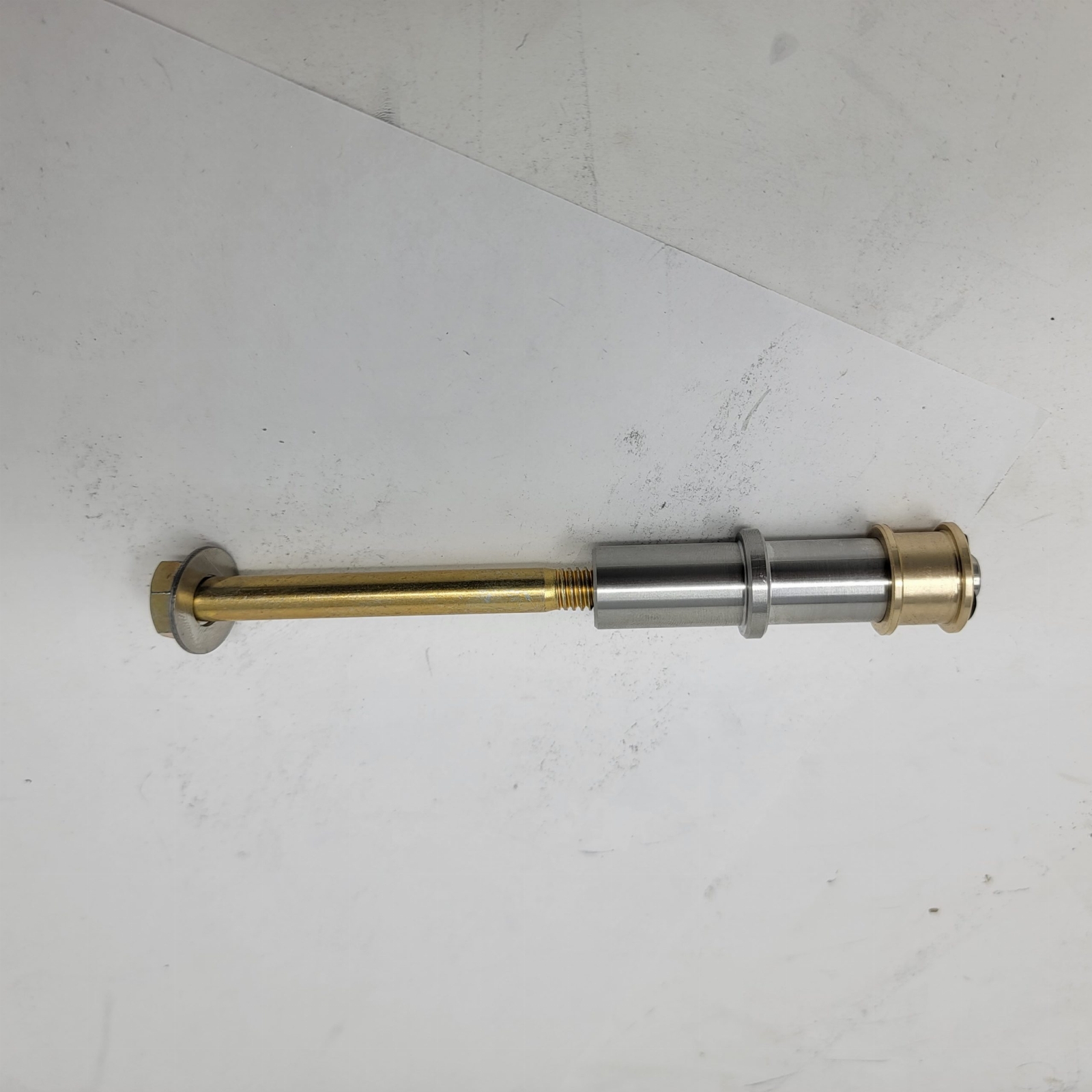

Yes sir. Someone on the board recommended them since they're made of brass and are said to be more durable.
Hmmm, this guy says he had trouble with the bronze looking ones, so ....
if you do do pins, don't do the bronze looking auto parts store bushings. I went thru about 3 sets of those. they just aren't right. there's a kit on Amazon with a harder gray bushing that has listed me a few years now and still going
XtremeAmazing Door Hinge Pins Kit 1988 2002 2 Door 4Pins Bushing Kit for 88-02 Chevy GMC GM Fullsize Truck SUV https://a.co/d/cJxmBuR
Yeah, bronze isn't brass I guess, but brass is pretty soft.
yes, bronze. Just checked the site to confirm. It didn't take the shop long so I guess it was simple enough for them.

let use know how the brass hold up. the Dorman ones I was calling bronze is just the color to me. could well be something else. whatever it is it breaks apart in a few months of use. these others were a darker sliver color and got good reviews on Amazon. if yours are actually brass, like brass fittings are made of. it should be way better than the Dorman stuff.
