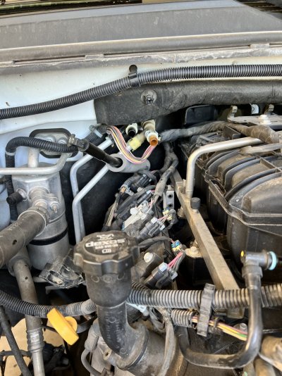

Cleaned the throttle body. Found the front two VLOM bolts loose. I snugged them up and put things back together. It doesn’t look to be too hard to take the intake off and retorque them. Just need to find a day to do it.
there's a theory that loose bolts are the cause of afm lifters sticking. it says being loose allows oil to leak internally on its way to the litter, over time the lack of lubrication inside the lifter, the plunger starts to gaul up and sticks. very tight tolerance in there.
no clue if it's true, but if you have active afm, probably worth tightening. if you don't have afm, eh they are always loose on every ls with any miles on them. my ls3 had some so loose you could take them out with your fingers at 100k. but eh, no afm so nothing to hurt.

Trying to get the ground strap bolt out of the back of the driver's side head. Not looking good, boys.
if I remember right, flex head gear wrench to get on it, and still had to use a pry bar against something for leverage to break it loose. amazing how gm will tighten a random ground torqued to within a mm of failure but volm cover, eh. snug at best.

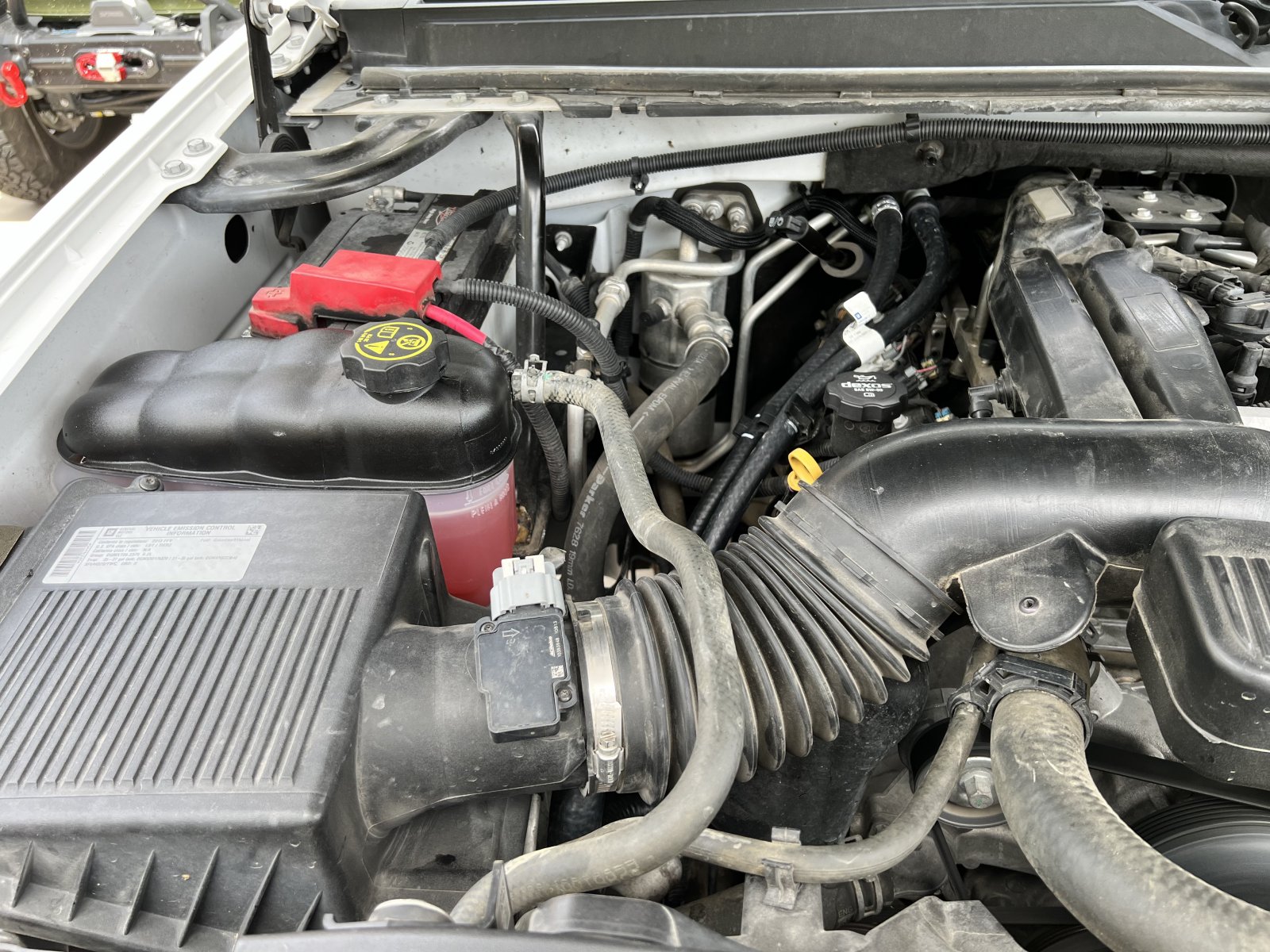

No, I just pulled the hoses and let her drain. Took about 3 gallons. It wasn’t a true flush. More of a drain and fill. It had a new gm radiator at 100k miles and they flushed it then. The “old” fluid was like new clean.

Hell I’ve had this crap for weeks. I figured I better do it. After 50 this gets to be too much. I’m beat. I will say, you can go down a rabbit hole with this stuff. I had originally just bought the Ts. Then I was like, well while I’m at it……and on and on and on….
