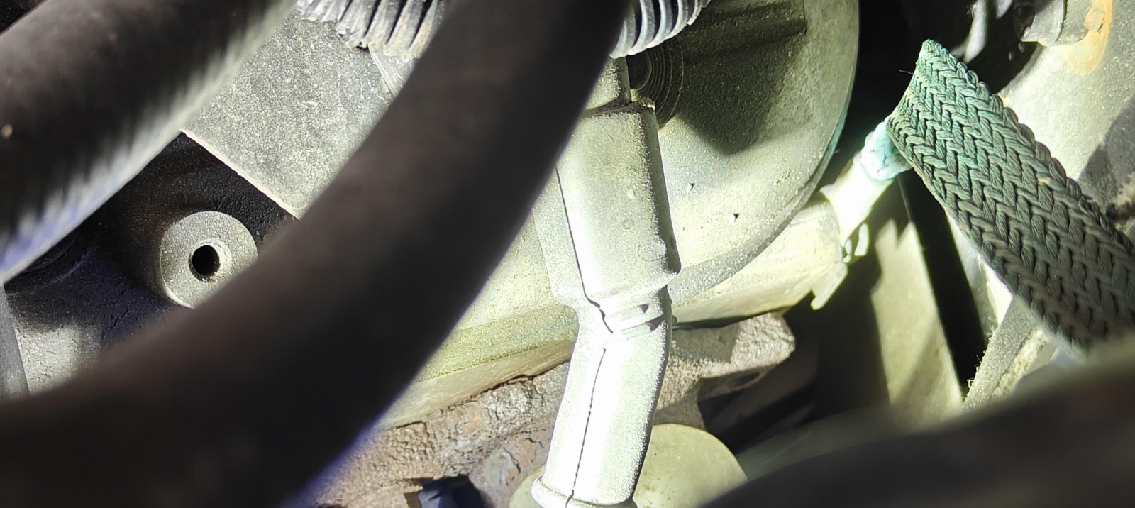

Spotted the culprits of (some of) the new noises under the hood. They must have popped off on the drive back from Acadia Nat'l Park.
Rear manifold bolts, on both banks.
My drivers side rear bolt head is gone. Noticed it about 6 months ago. I have a package of new ARP bolts waiting to go on. Probably get around to it sometime this month

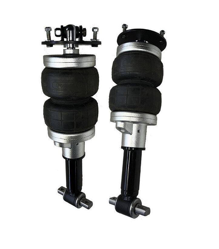

It's not a kit. i.e. an aftermarket kit with bags something.
Yes, for a better ride. I was in a friends tahoe that had it and it was a lot more comfortable. : )
I'm a sucker for softer ride. do you have a thread about them?
I'm guessing you run a softer main spring with the airbag in it to adjust ride hight and get the progress rate of the air too for a nicer ride over the washboard stuff?
I have the z55/z95 stuff too. I went as far as to email the old retired gm engineer that sells a tune for the corvette mag ride. supposedly it changes the whole car, touring mode is actually nice and track is track. not the oem tune that you didn't know what position the switch was in, you'd never feel the difference haha.
he said the software/hardware would all work. but at this point he's enjoying retirement and doesn't want to take on the project. he'd need a test truck and all to tune with.
it's a shame, but I get it. be nice if at some point he lets that info slide somewhere so the smart DIY code guys can take it from there a touring tune a sport tune and a towing tune would be really nice.

I just bought both Dorman repair clamps. Should be fun.
I'm thinking about removing the manifolds when doing motor mounts. Too risky? I'd rather replace the bolts now than worry about them. Is head removal the only way to fix it when one snaps?

Converting back to the stock autoride air suspension- new struts plus new upper and lower arms because the ball joints were bad.
The only major component that hasn't been replaced are the axles because they are in good shape. Will be doing the driver side soon.
there is a available front air-strut
this makes me even more curious.
as bag on shock and air bag inside spring all in the front end?
I need more info haha.
Why does everything on this truck feel like a ticking time bomb?
easyout, if your lucky
manifold bolts have been breaking since forever, randomly just the way it is.
