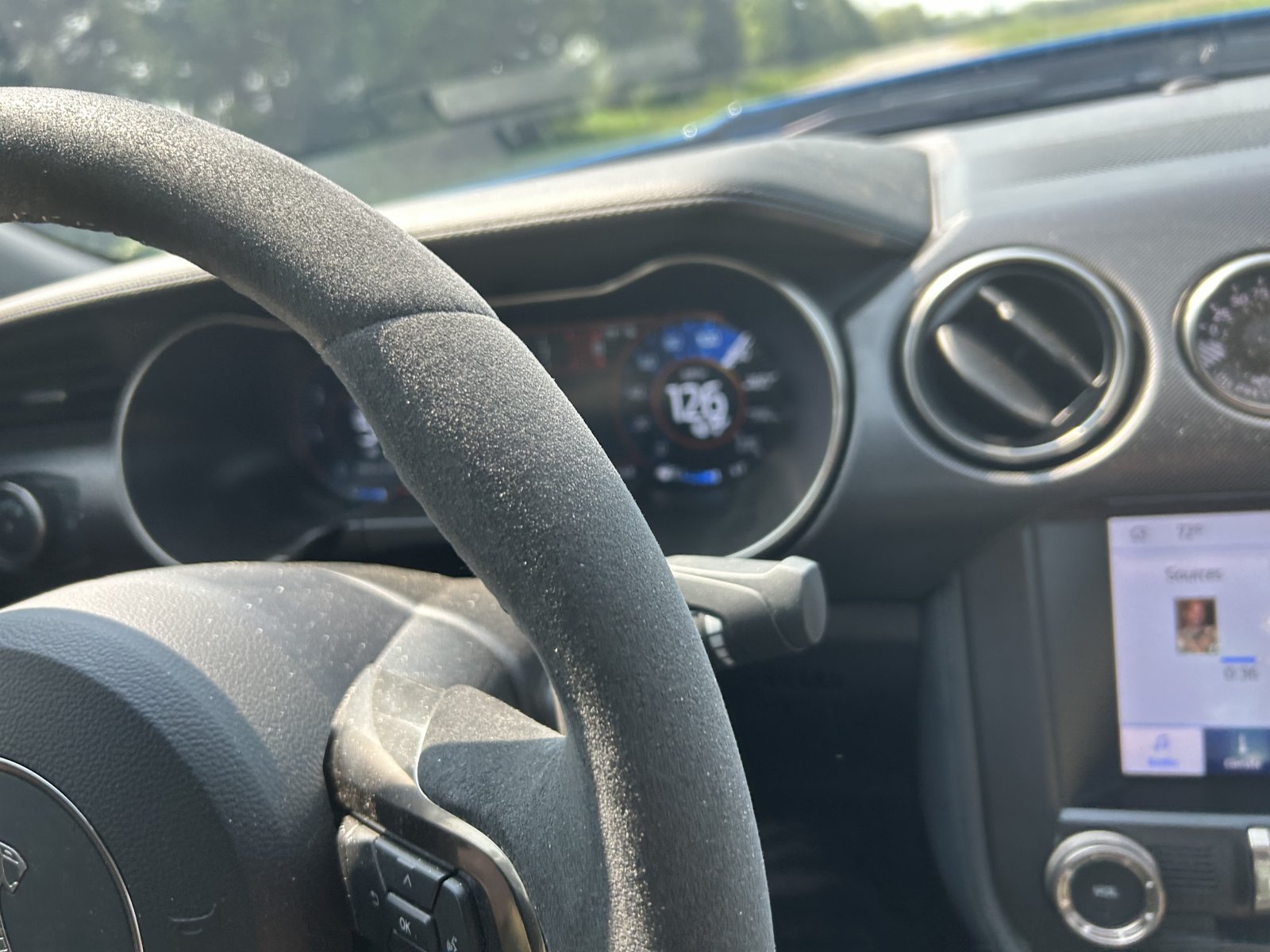

View attachment 400024View attachment 400025
We ran out of road in a 45mph zone yesterday, so I didn’t quite make it to 140.
