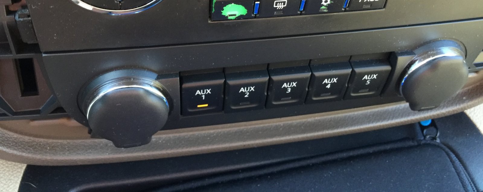

Installed my upfitter switch panel, but the backlighting doesnt light when connected to backlight wire. The indicator LED does work and dims accordingly. If I wire the backlight to the indicator dimmer, it works. But does not dim as low as the rest of the dash. Also, the light does not go out, I'm guessing it has something to do with the switch power being on constant (I have it wired to the INFO fuse) Might have to wire it to ignition power.
UPDATE: Reading about silicones that smell like vinegar, something about the curing producing acetic acid which will corrode copper on circuits. Need neutral curing silicone. I did silicone some blue bulb covers on the backlight LED's and it did smell like vinegar :(

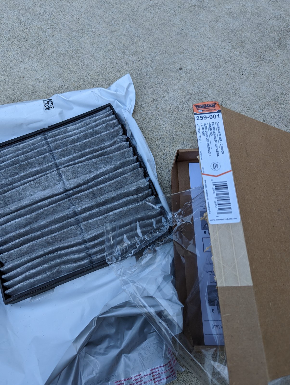

Fresh cabin air filter, old one wasn't too terrible I have pulled them out before full of leaves and dirt
funny I didn't even know we had one and then I noticed on the wix site they sold one with an asterisk about needing a kit installed to install it. checked and mine had already had it done, but when I pulled it out whoever put it in the top caught on something and they just jammed it on and it folded up. so it wasn't doing anything. glad I looked haha.
nice to have one. my 96 doesn't and the evap was gross.
