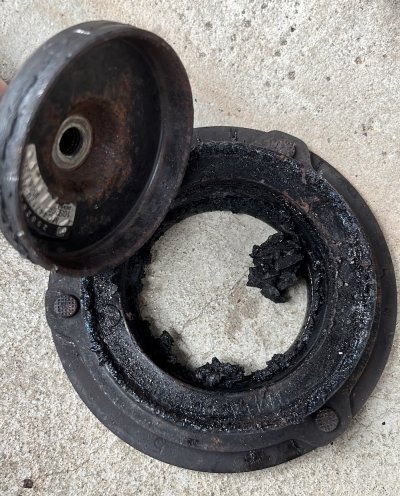

Removed the broken AC compressor clutch today. The rubber part of the clutch must have separated last time I drove it (making horrible squeaking noises), then it melted due to the pulley still rotating and not driving the compressor anymore and while this happened the clutch gap went to zero and it burned the friction surface too. The whole clutch is toast, but thankfully the compressor seems fine. There is no oily residue of any kind on the shaft and it spins smoothly. The Nachi bearing in the clutch was fine by the way.
This is supposed to be one piece:
