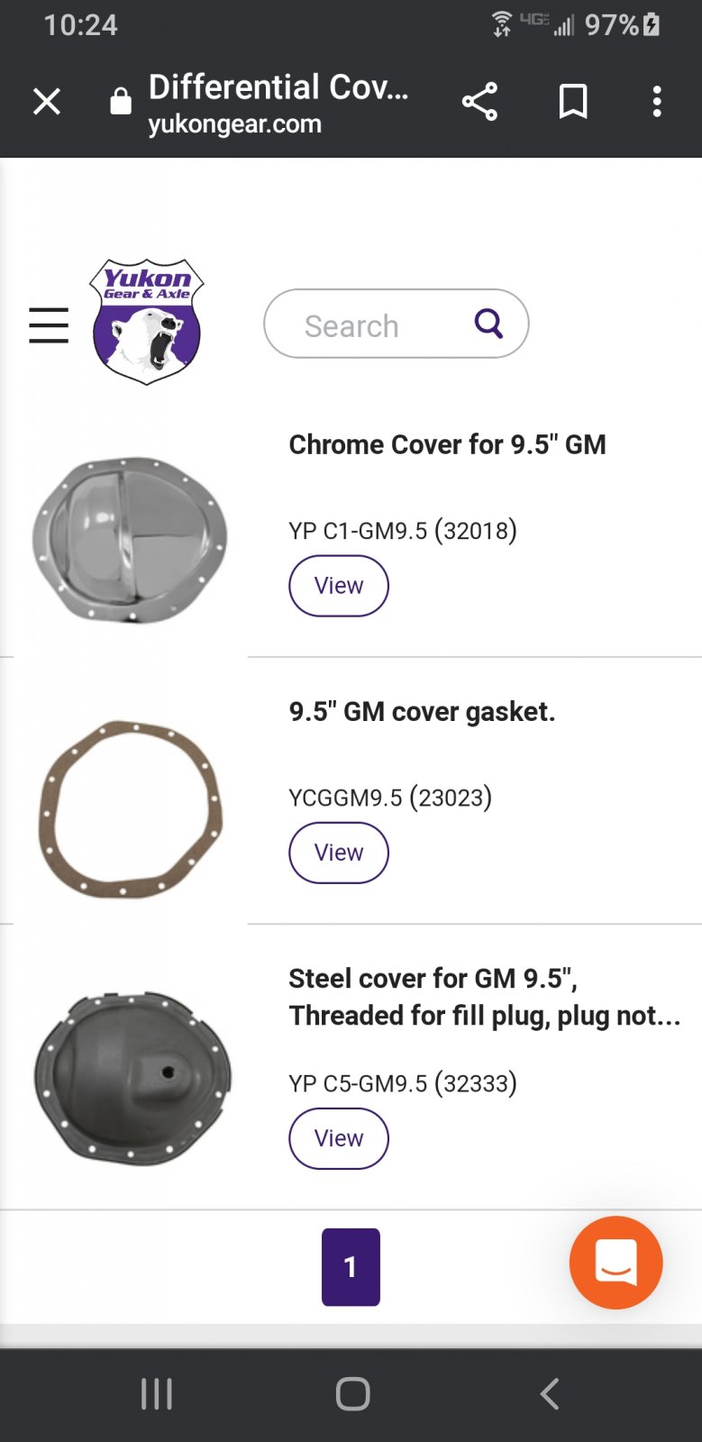

Anyone in here know of a decent semi-float 14-bolt 9.5" diff cover?
If mine is no longer straight and ceiling properly. I figure I should replace it with something fancy.
pml is the only one that fits with the panhard bar iirc
It is what I have on mine, i like it except that it's raw aluminum, and almost like stains if you get gear oil on it. Powder coat would've been nice
Damn that's a price! Lol
Thanks for the quick reply

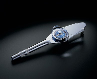

Question, how many of you guys have replaced your pinion seal? Any tips would be much appreciated.
If the pinion appears good as Wes mentioned, then changing the seal is not too big a deal. First thing after pulling the driveshaft is to scribe a line on the pinion and pinion nut so you know where to torque it back to. You're supposed to use a new nut.
Before you remove the nut with an impact gun, use a beam torque wrench or one like below to measure the rotational force in inch/pounds.
When you torque down the nut after installing the new seal and line up the scribe marks, you want to use the torque wrench again and make sure the number is 3-5 inch/pounds more or else you'll have to take it apart.
Bought a new AAM one and still need to send it out for powder coating. Orange of course as it's a pumpkin!
