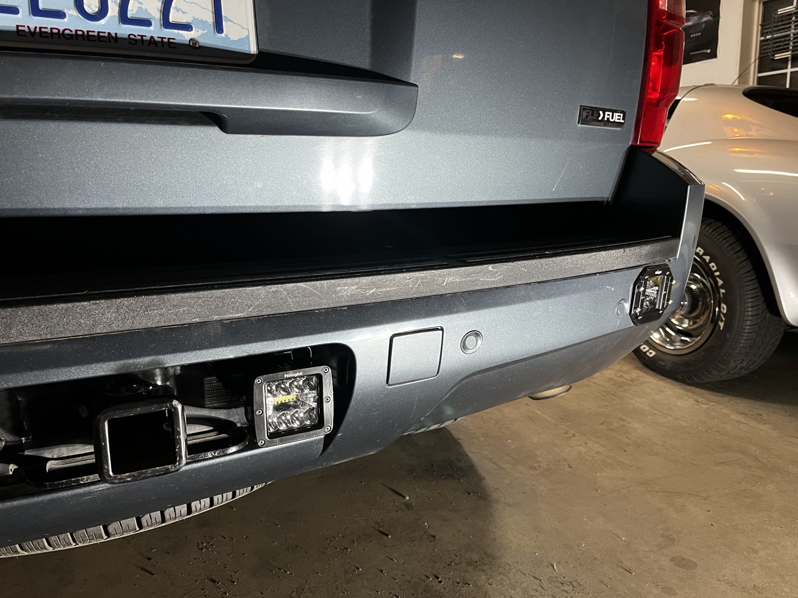

Been adding some lights over the last few weeks. Small light bar in front, surface mounted to top of bumper. Then in back I first did two flush mounts inside the bumper - they shine out from center quite a bit so I added a third surface mount just to the right of the receiver. Switch mounted to lower dash panel below the headlight switch. Everything is NiLight brand, including wiring kits with relays. Out of box quality seems pretty good and good prices on Amazon. 88B66C62-88D7-44BB-9922-D50E7A6222F3.jpeg
