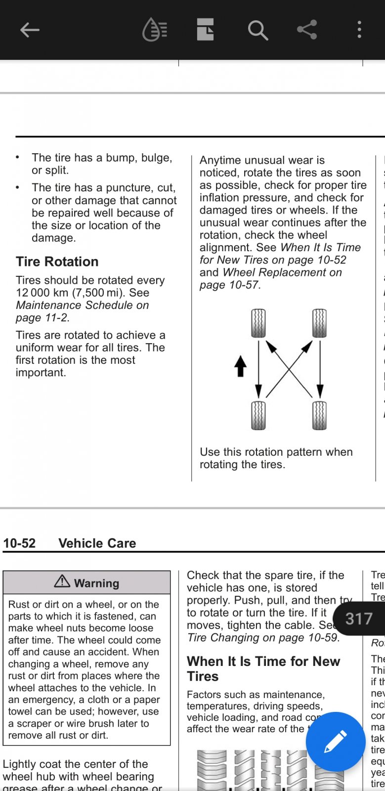

My money is on the reverse centrifugal rotation of the wheel being swapped from one side to the other caused the sensor to skitz out on me.
Then all your sensors are in for a treat cuz swapping sides is part of the proper tire rotation pattern, according to the manual. Or do you just do fronts and backs on the same sides?
I think only 2 of the 4 swap sides on a rotation stated in the manual. The other 2 stay on the same side and just move to either front or back.
From my 2012 manual
From the 2015 Acadia manual

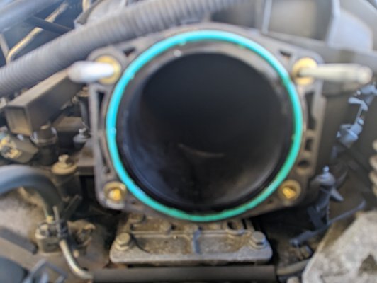

Cleaned throttle body and MAF at 247k miles. Last cleaned around 150k and didn't remove throttle last time. I did open the flap a bit to fit toothbrush for cleaning but no relearn process needed.
From my 2012 manual
Right, but, at some point, all the wheels end up being ran in both directions. My point was that the sensors shouldn't be skitzing out over this. I've driven backward plenty fast enough and for long enough to know. :p
I double-check on unfamiliar cars. But generally, it's "cross the non-driven wheels".
Yeah, I don't think it matters which set crosses as long as you do it the same every time. Both of the cars I showed above are AWD and they both show a different way, lol
