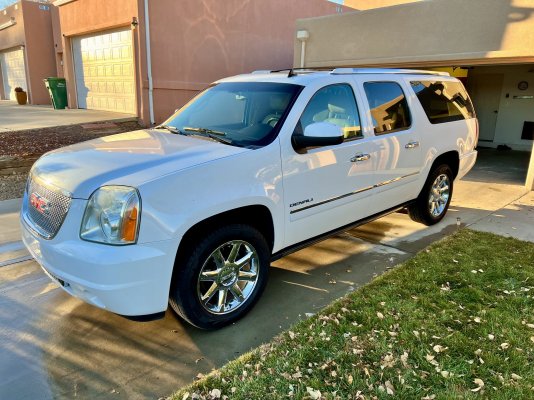

Added a OEM transmission pan with an added drain plug. I started with drilling a hole in the original pan, to make it a lot less messy. Not sure why you would ever try to save the pan when you can buy a OEM GM pan for $15 on rock auto. Lol. I originally did that until I found a company on eBay that sold the OEM with drain plug already. Replaced filter and filter seal.
Will drain and fill next month. Took exactly 6 quarts. Last thing to do is the rear diff. Already did TC, front diff and oil/filter.
The fluid was really dirty but there was very little of anything in the original pan. Even the magnet wasn’t what I was expecting after 130k. I don’t think it’s been changed but it seemed too clean for that many miles. The inside of the tranny looked brand new.
