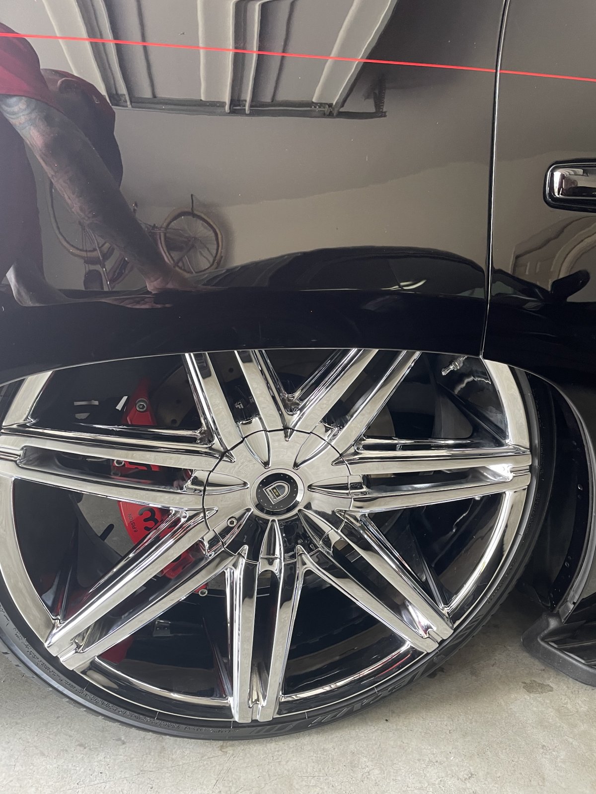

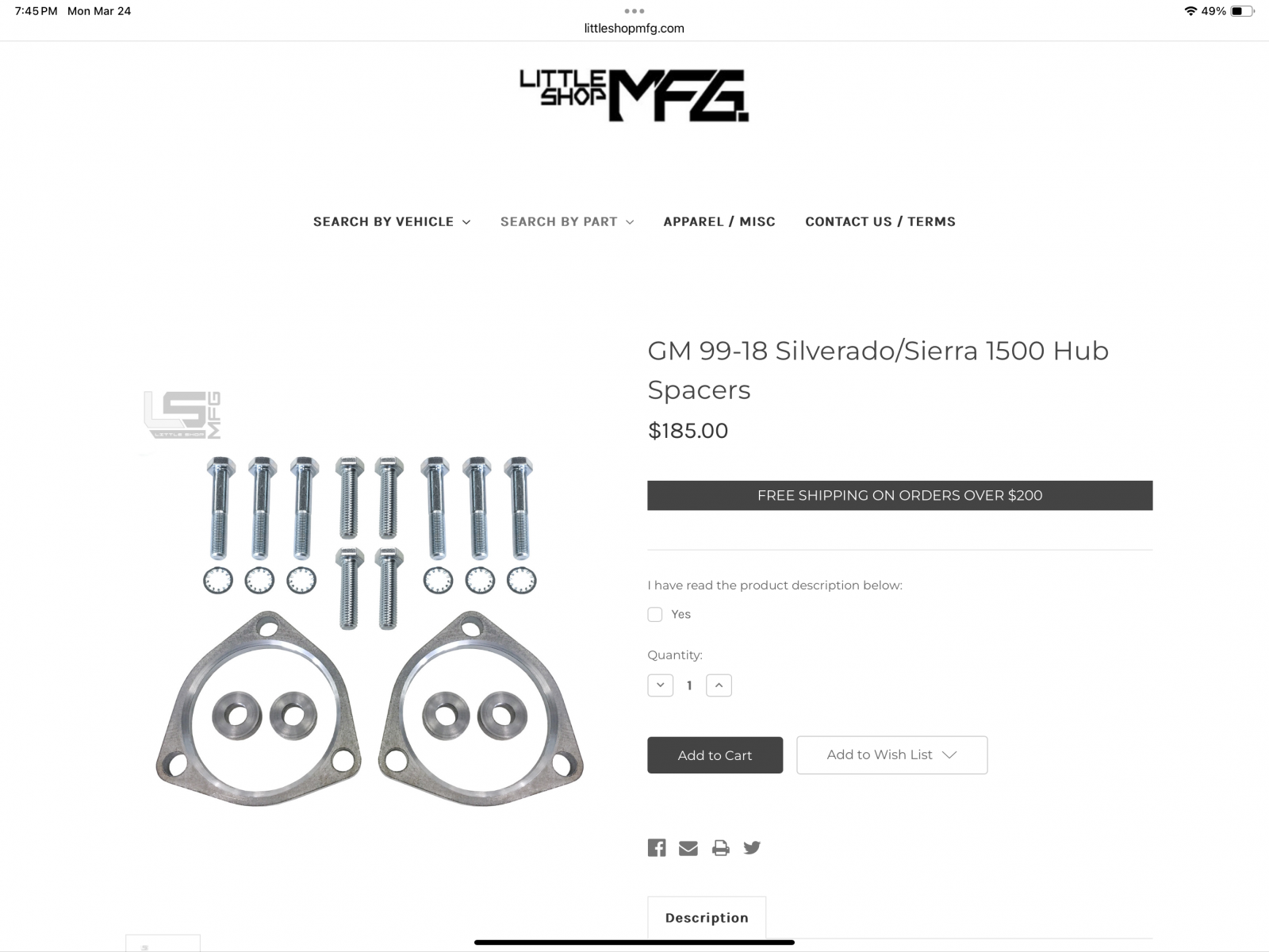

Did you have to add hub spacers to fit those ? I added some from Little Shop on my SFBD 08 Silverado when I did my Wilwoods but I’m running Intro wheels with way different offset from what you have. Hard to tell but it looks like you’re pretty damn close to the fender lip. I like being able to drive around town when I’m skating and still be able to take most corners.
NASTY GM
Jun 15, 2009
780
313
Nor Cal
Did you have to add hub spacers to fit those ? I added some from Little Shop on my SFBD 08 Silverado when I did my Wilwoods but I’m running Intro wheels with way different offset from what you have. Hard to tell but it looks like you’re pretty damn close to the fender lip. I like being able to drive around town when I’m skating and still be able to take most corners. View attachment 453381
I used this same kit. The rear axels had to be removed, now the caliper is on the back side. I can skate, the watt keeps the rear end centered :cool:
26,678
52,942
Why did you remove the rear axles? In order to change the orientation of the brake backing plates because you had clearance issues? Mine are mounted forward on the rear brakes. I have a 3 link in the rear that keeps things centered. My rear end is narrowed enough to tuck 26 x 12 intros with 10” lips, no clearance issues.

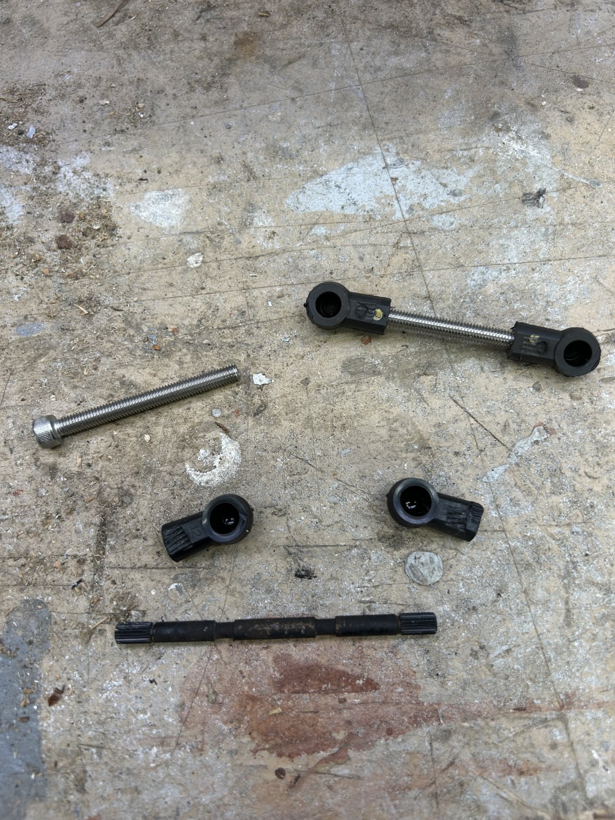

I just flipped the struts to the bottom of the LCA’s on the Tahoe and found out I have the aluminum control arms so no extra spacer is needed. I hope it doesn’t drop it too much. I also modified the rear ride height sensor rods for the 4” rear drop but that’s a guessing game. Trial and error will be my friend there. The stock ones were 4”overall. I’ll try them at 3” and adjust accordingly. Waiting on FedEx to deliver the rear springs and shock extenders.

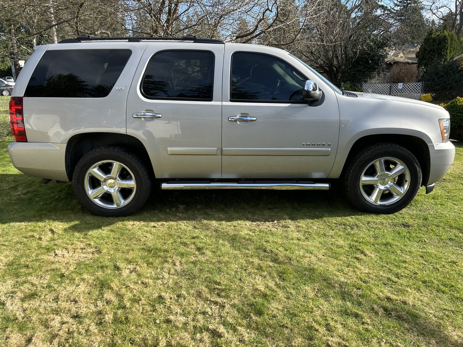

All done with the 2/4 drop. The rear is still settling but I have about a 2/3 drop now. The auto level is still calibrating too I think. I’ll run an ALC trim set with the Tech 2. $230 total for the parts. Way better than stock height. I didn’t get a before shot in the driveway but the yard shot is still valid.
Sir_Hiro
Automotive Mad Scientist
Jan 28, 2025
287
710
All done with the 2/4 drop. The rear is still settling but I have about a 2/3 drop now. The auto level is still calibrating too I think. I’ll run an ALC trim set with the Tech 2. $230 total for the parts. Way better than stock height. I didn’t get a before shot in the driveway but the yard shot is still valid. View attachment 453426View attachment 453427
Damn..If I wasnt going for an overlanding theme id lower mine cuz this looks great.

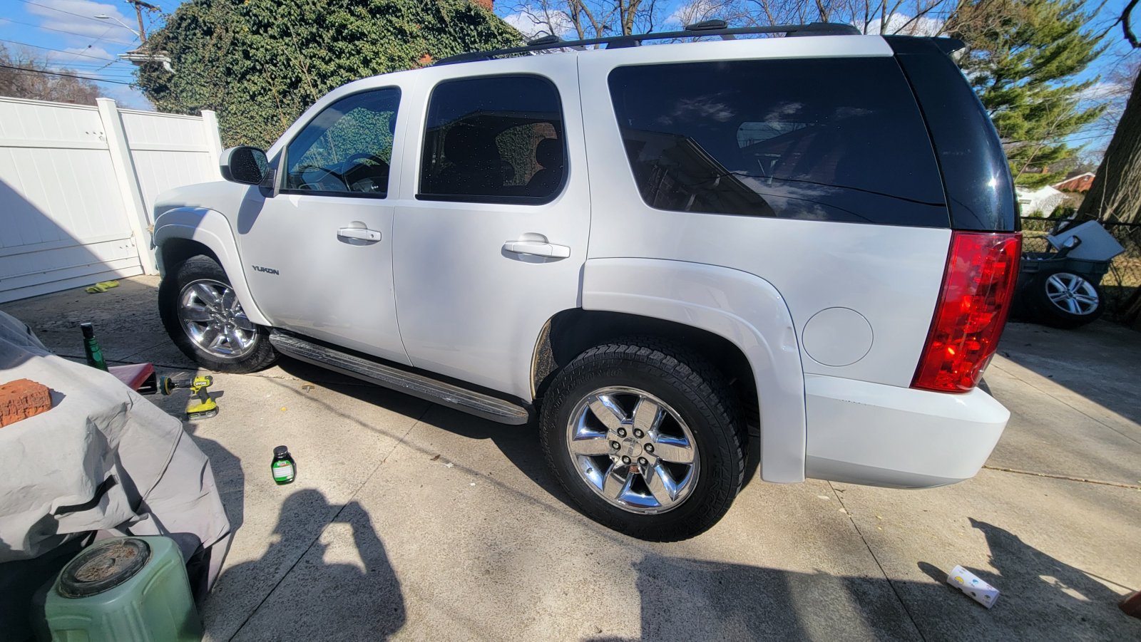

20250326_161030.jpgGot the drivers side moldings fully removed and entire drivers side cut and buffed. Still waiting on this Michigan weather to figure out its life to get the two door flares on.
Still debating on removing the Yukon Badge from the doors.
