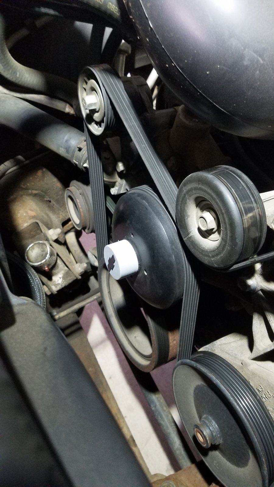

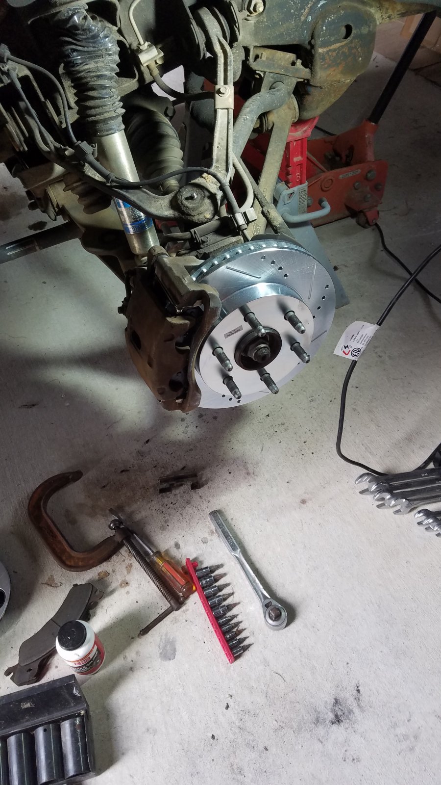

Did the front brakes and installed a pulley cover thingy.

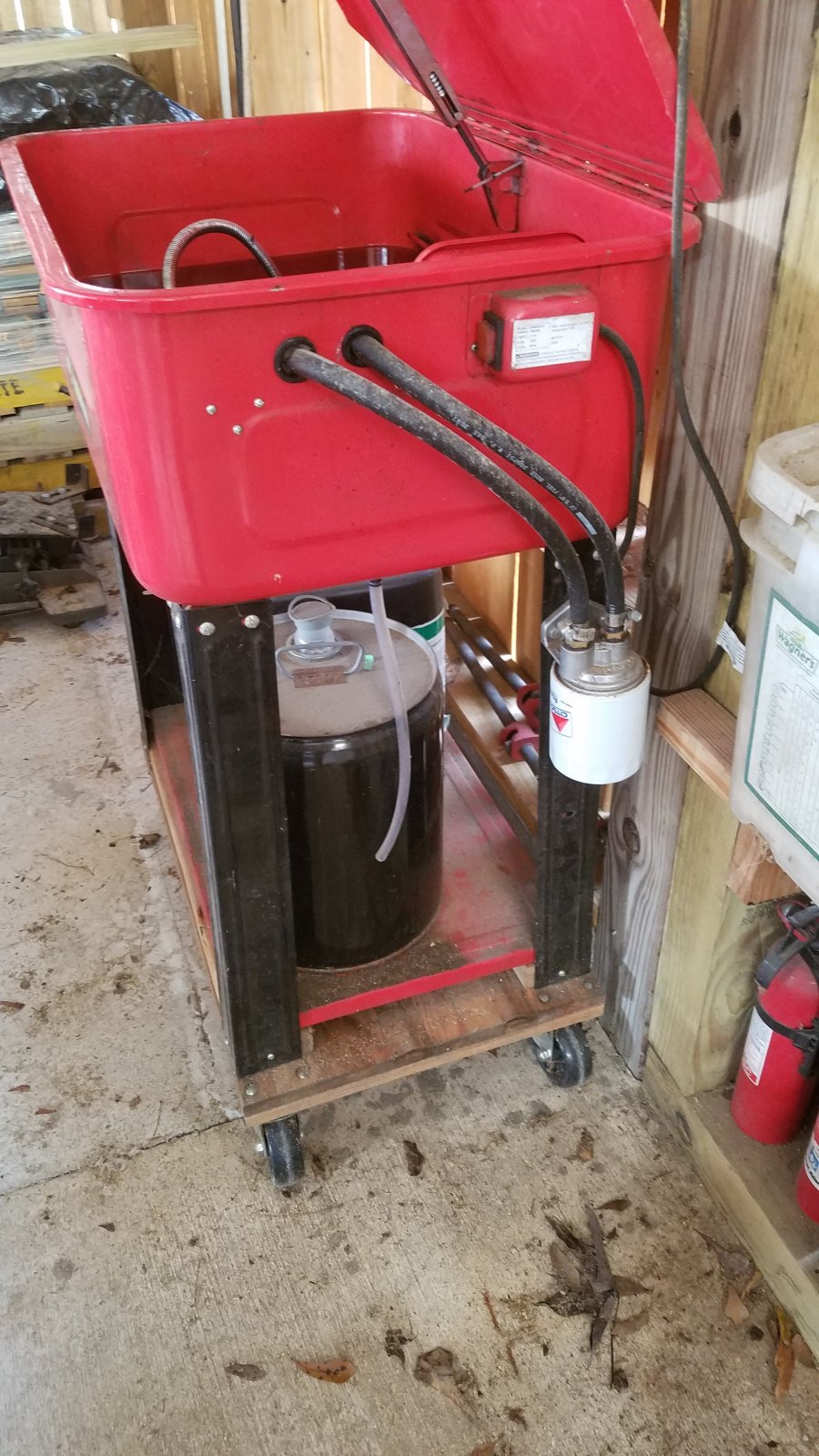

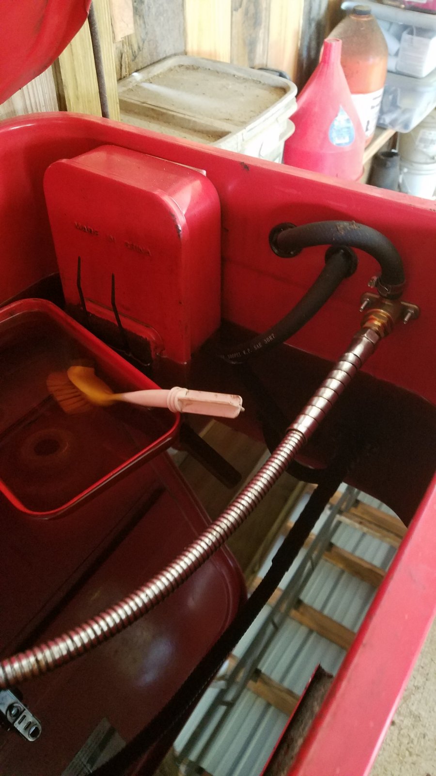

I cleaned the brake pad holders in my upgraded solvent tank so I shot a couple of pictures of it. Installed a petcock drain, external spin on filter, relocated the spray wand, new pump with brillo pad pre filter and lowered the shelf and bolted it to a carpet dolly so it's on wheels

Where can one find CITGO filters these days?
