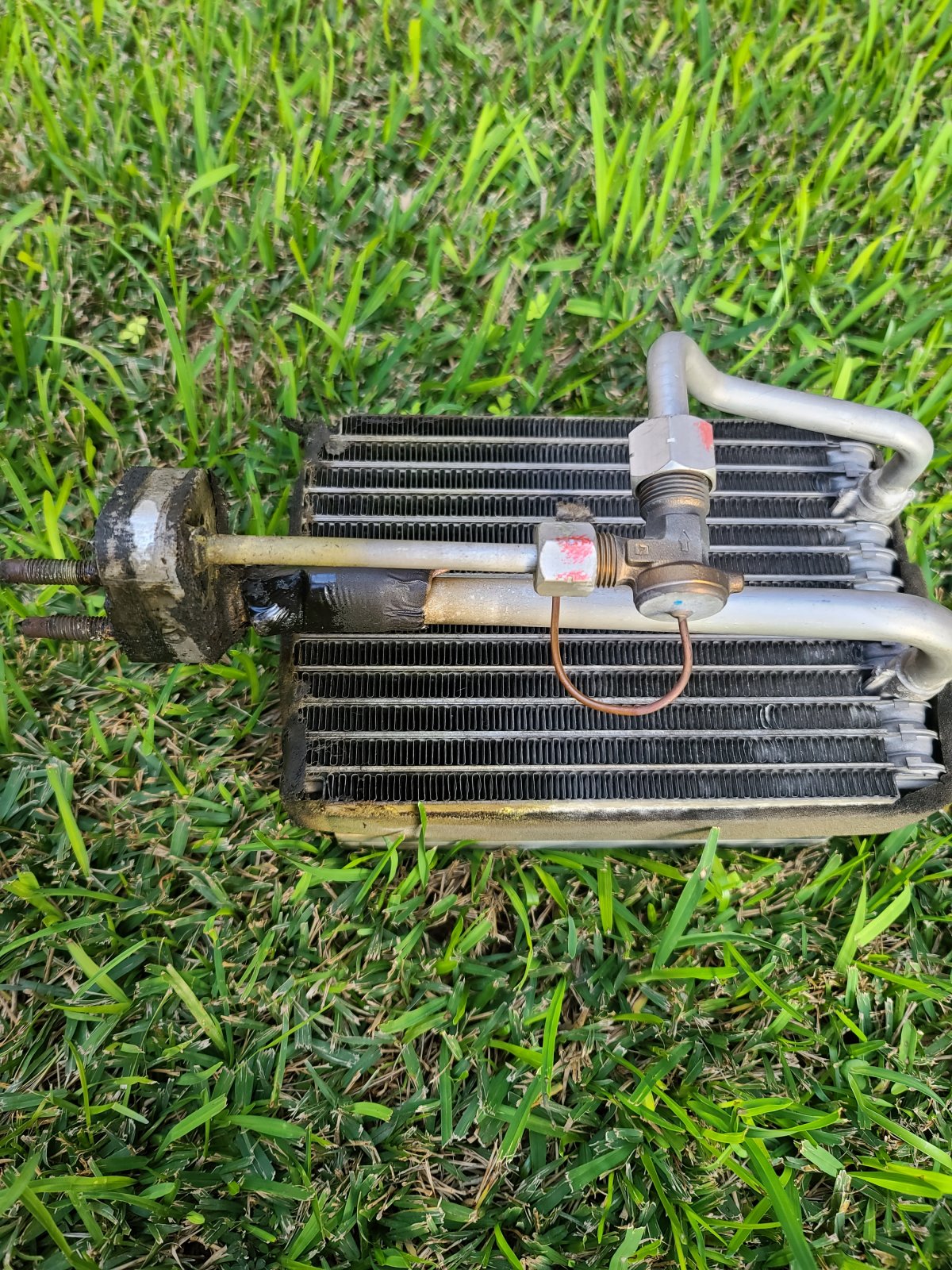

I'm almost done replacing the rear evap core. Went with an ACD unit and yes it was confirmed leaking. Probably pull a vacuum this afternoon and charge it back up. Came to grab some food
Got it done. Vac and charged. Blowing nice and cold again. I didn't install the new compressor or accumulator. Will probably do that sometime this winter. Will see. NOW I can install my new wheels tomorrow!!

Pic of the old rear evap. I charged it with r134+ UV die, for future leak hunting.

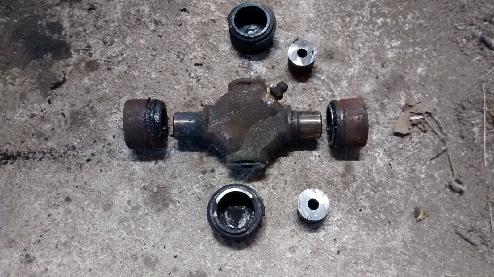

This is what I did today :
After 338K, the original finally started causing some vibration above 65MPH.
I only had propane to melt that injected nylon, and what didn't leak out just laughed at my 12 ton press. Not to mention that the outer edge of the yoke had a high spot that the impact socket just wouldn't sit still with. I didn't want to take a socket to the junk, so to avoid that, I cut it into pieces and pressed out the 2 caps separately.
What I found odd was that the rear u-joint had a zerk fitting but the front one doesn't.
I am also thinking now that I need to mix up some epoxy to fill these holes where the nylon was injected.
You don’t have to fill the holes. Just clean up the inside where the new caps will fit and install the new ones.
