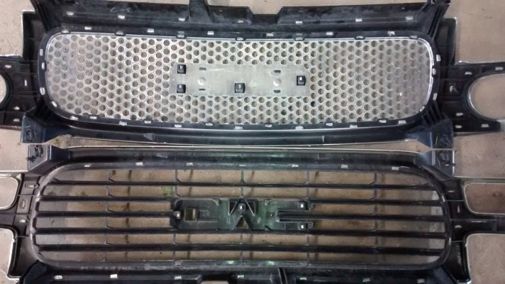

Well, the old Yukon delivered several kicks to my ball bag today.
I had Denali headlights/parking lights/grill all set to go on today.
First, I broke the retaining tab off one of the parking lights. First kick to the balls.
I tried to use some plastic welding epoxy to fix it with no luck. 2nd kick.
I zip-tied it into place as a temporary victory until I could get another. Swing and a miss.
So I go to put the grille on and the damned thing isn't lining up.
Check this out : IMG_20230513_190209453.jpg
- the Denali grille bottom mounting points are about 1 1/2" wider apart.
That was a direct shot. I crawled back inside and got out a bag of ice.
