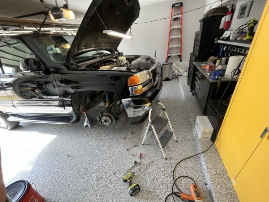

Got my front seats recovered on Tuesday, then today I tackled the AC drier and compressor.
Wish I had a garage like that to work in. I don't even have a carport or even an actual paved driveway anymore since I recently moved. I have to do everything in the grass or the gravel/crushed stone driveway. That stuff is HELL on your back when changing the oil.
