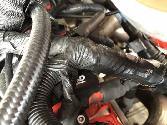

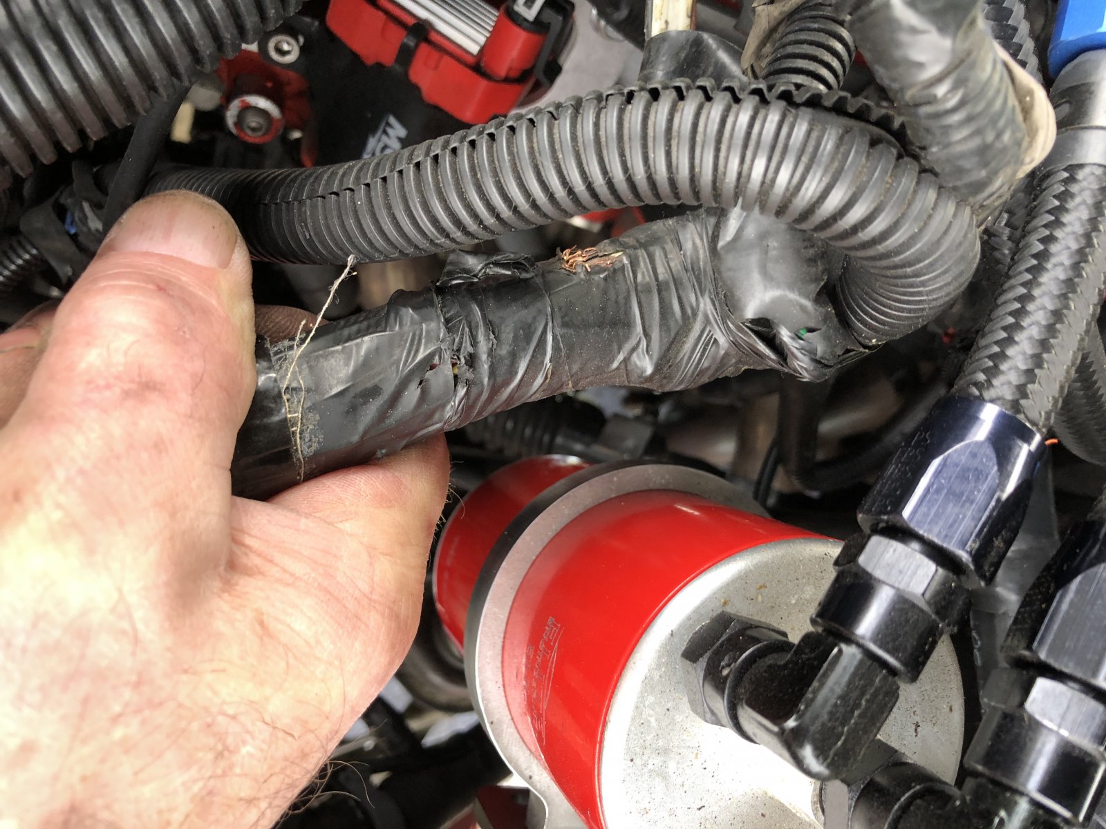

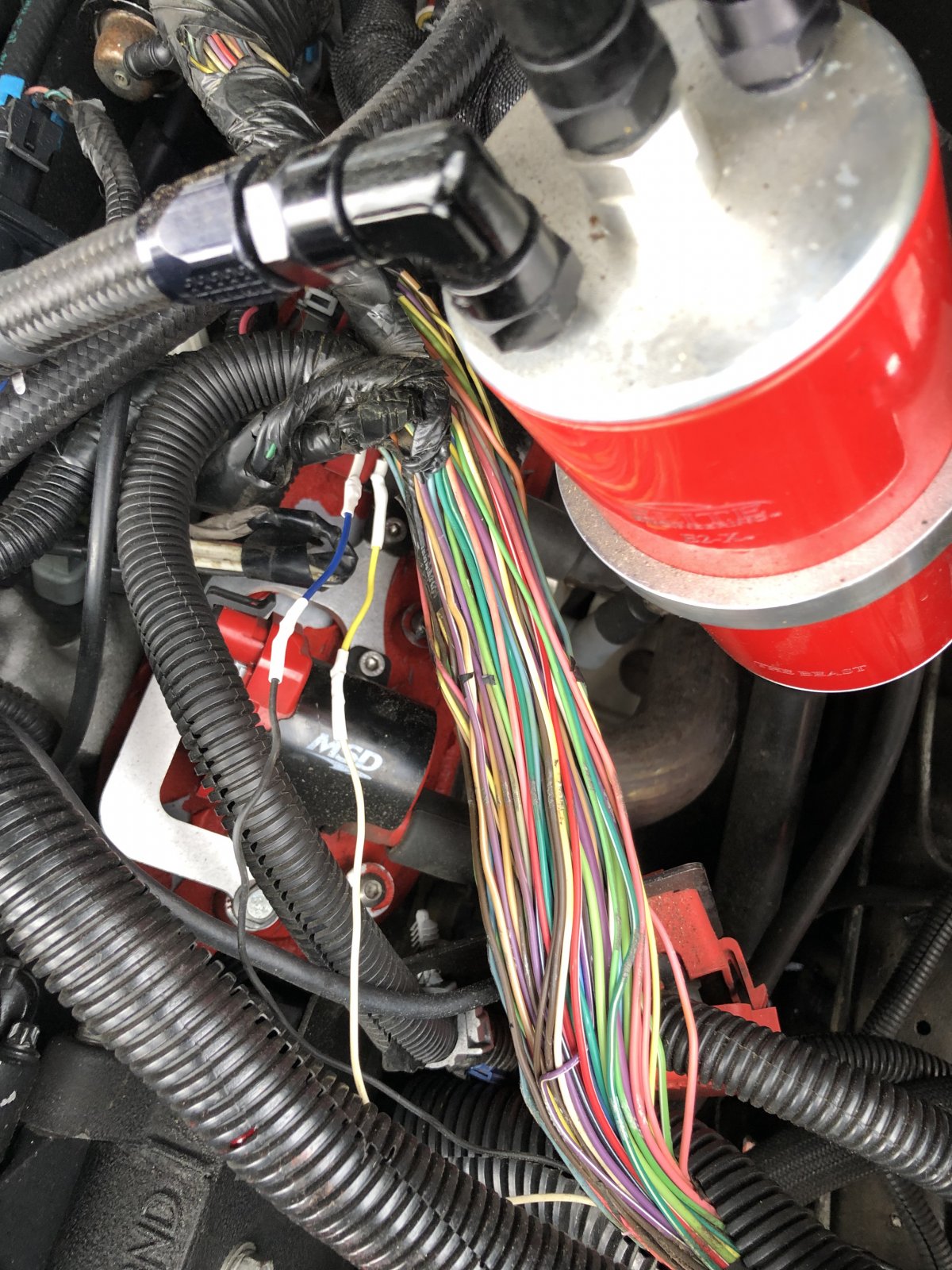

I fixed my no crank issue, found a spot on the wiring harness under the hood that’s been rubbing on a coil. It just happened to wear through both the ground and crank voltage wires for the starter relay. It wasn’t even really noticeable, I just saw the harness laying on the coil so I lifted it up and used a mirror to look under there. Starts right up now.
