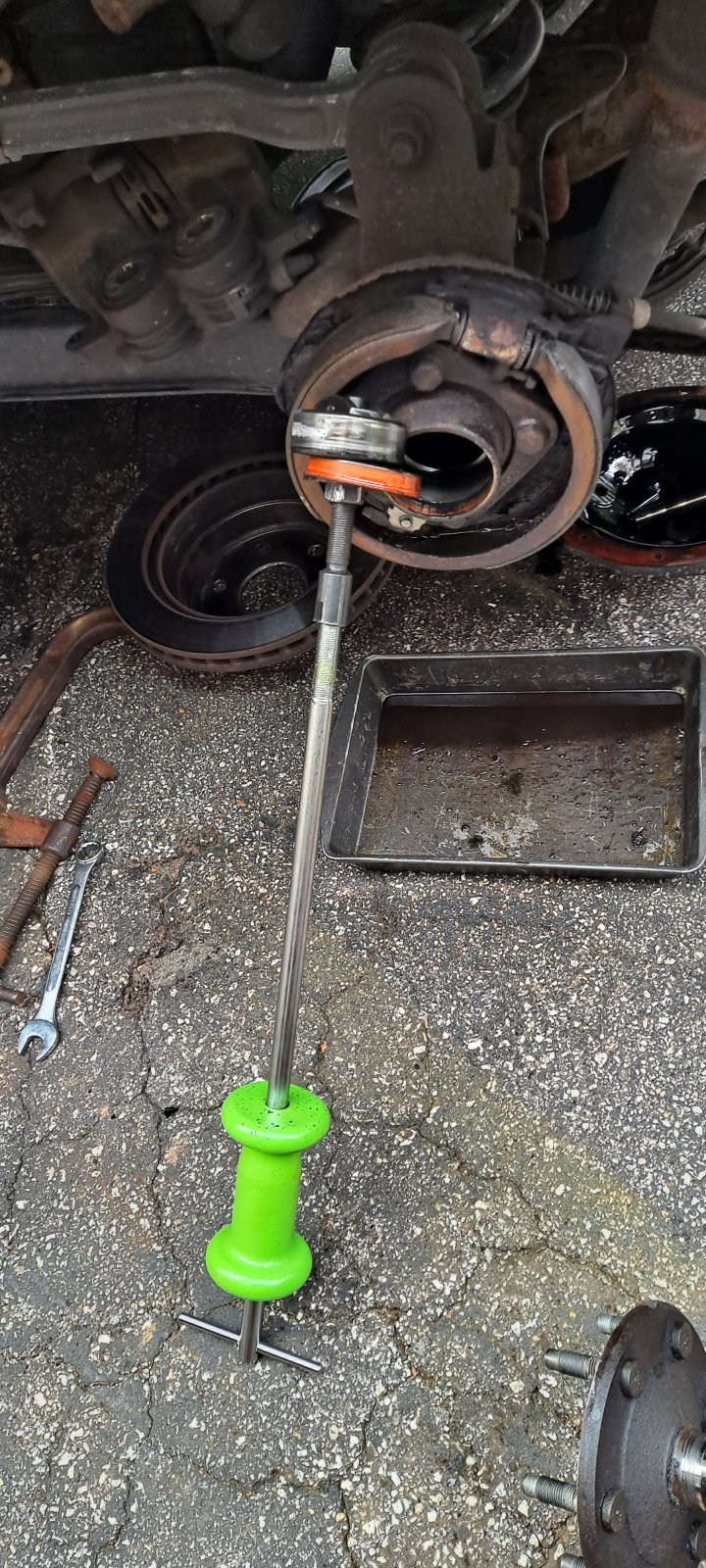

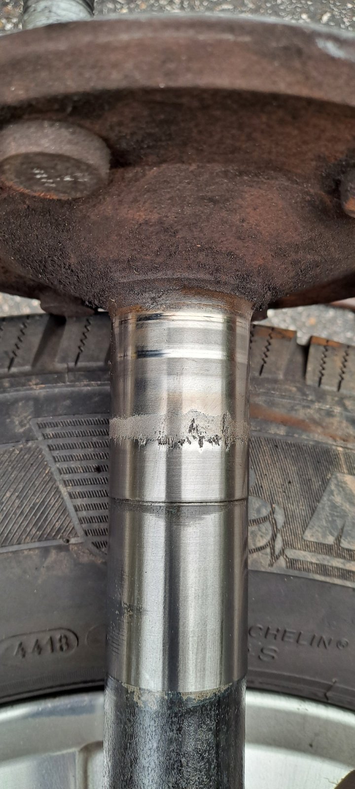

Replace the rear wheel bearings and seals on both sides even though one seal was bad. I figured it was time at 315 k. One of the bearings exploded while I was using the slide hammer it was a little tricky to get out after that. That same side had some pitting axle shaft. Nobody around me had replacement shafts available so I used it anyways. There is no abnormal bearing hum before or after. Airbag bag light came on last week and replaced sensor number two on the passenger side I can see why it was malfunctioning, LOL. It's nice driving an old truck like these without having any warning lights on in the dashboard.

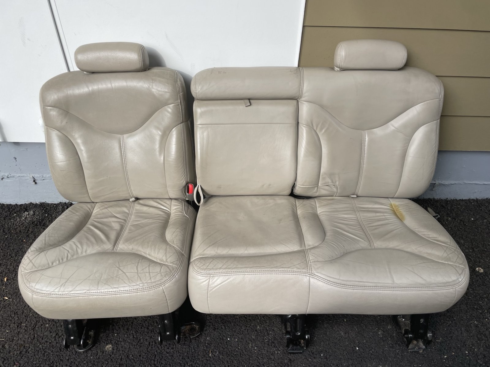

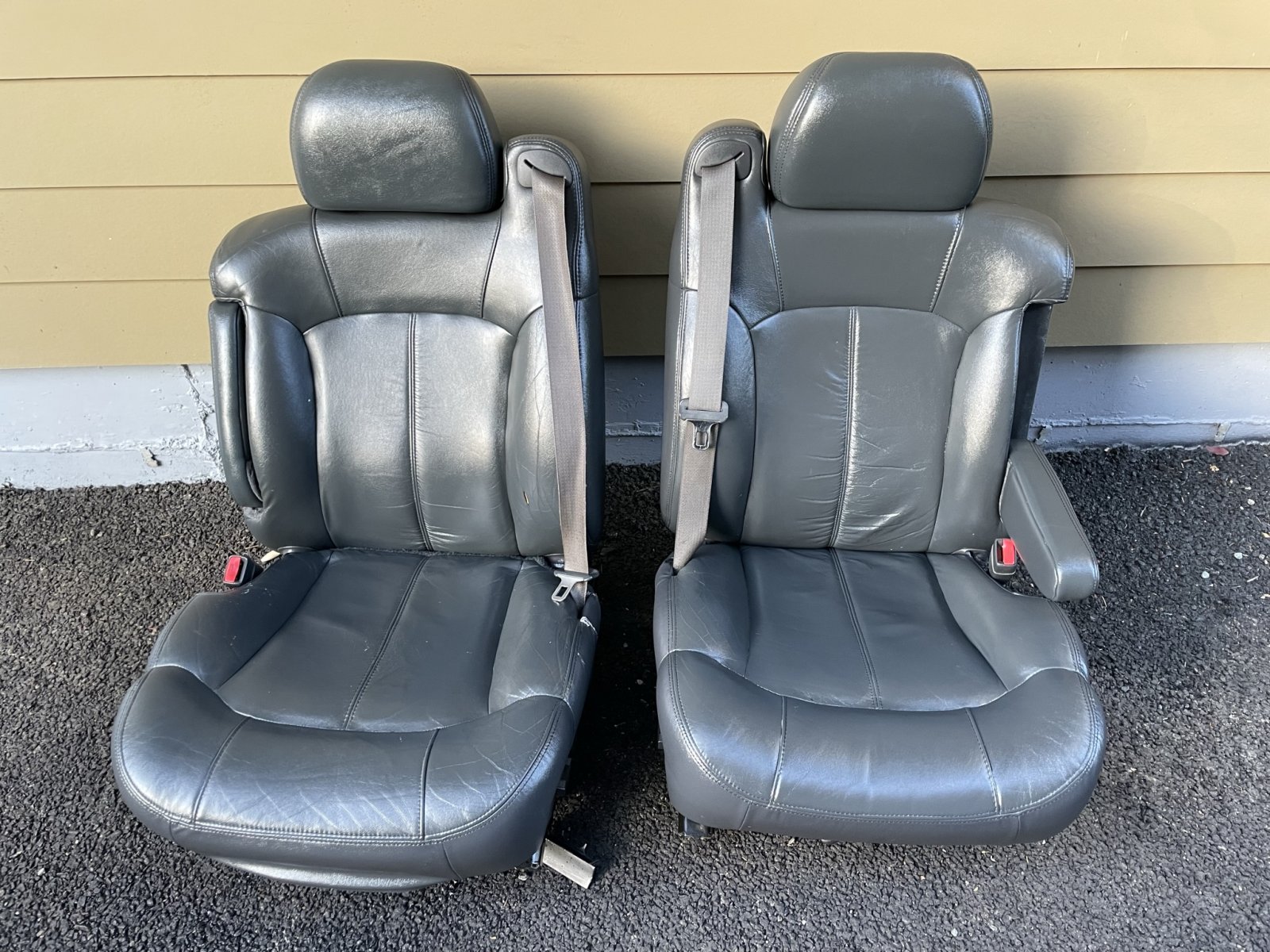

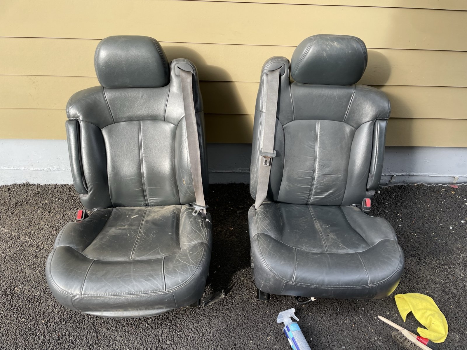

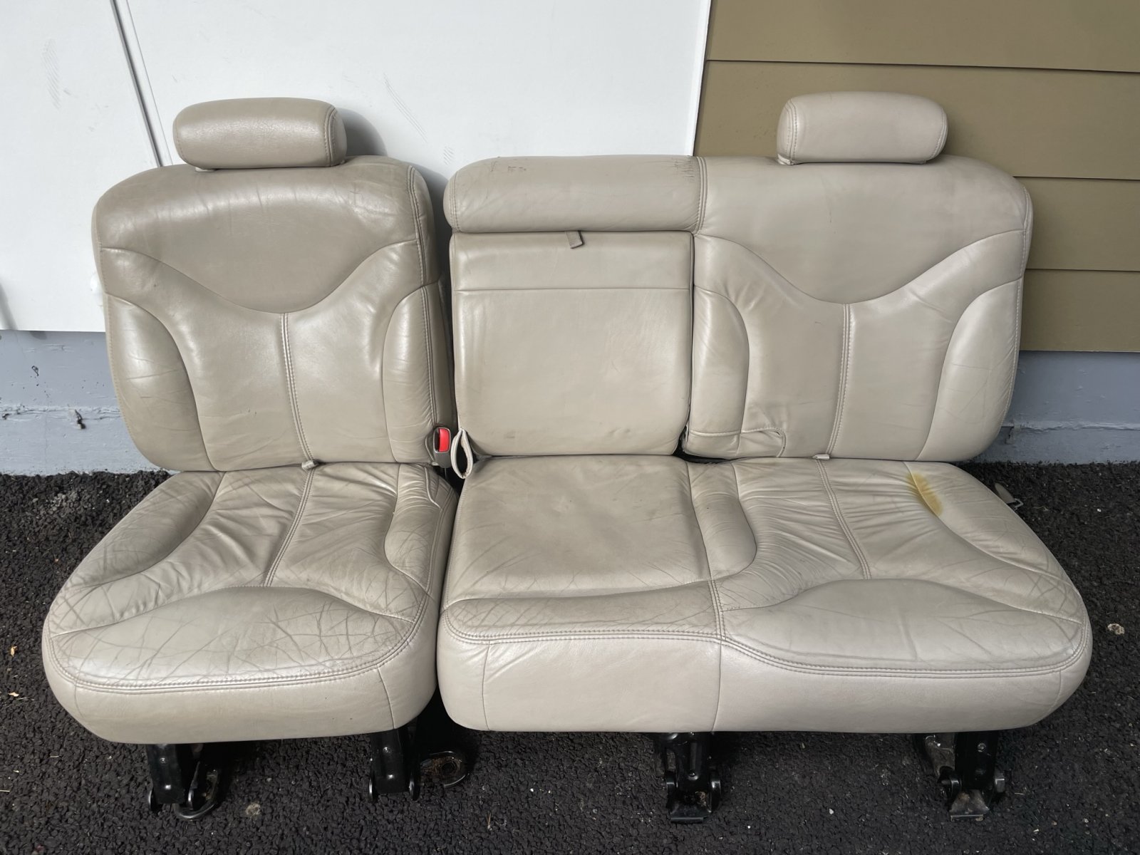

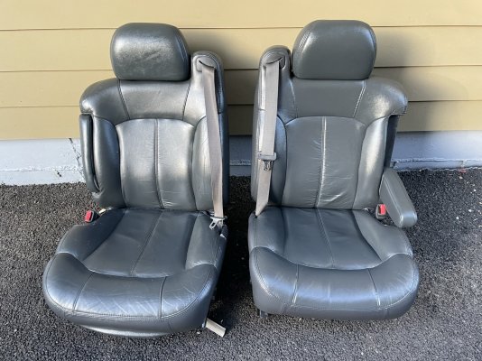

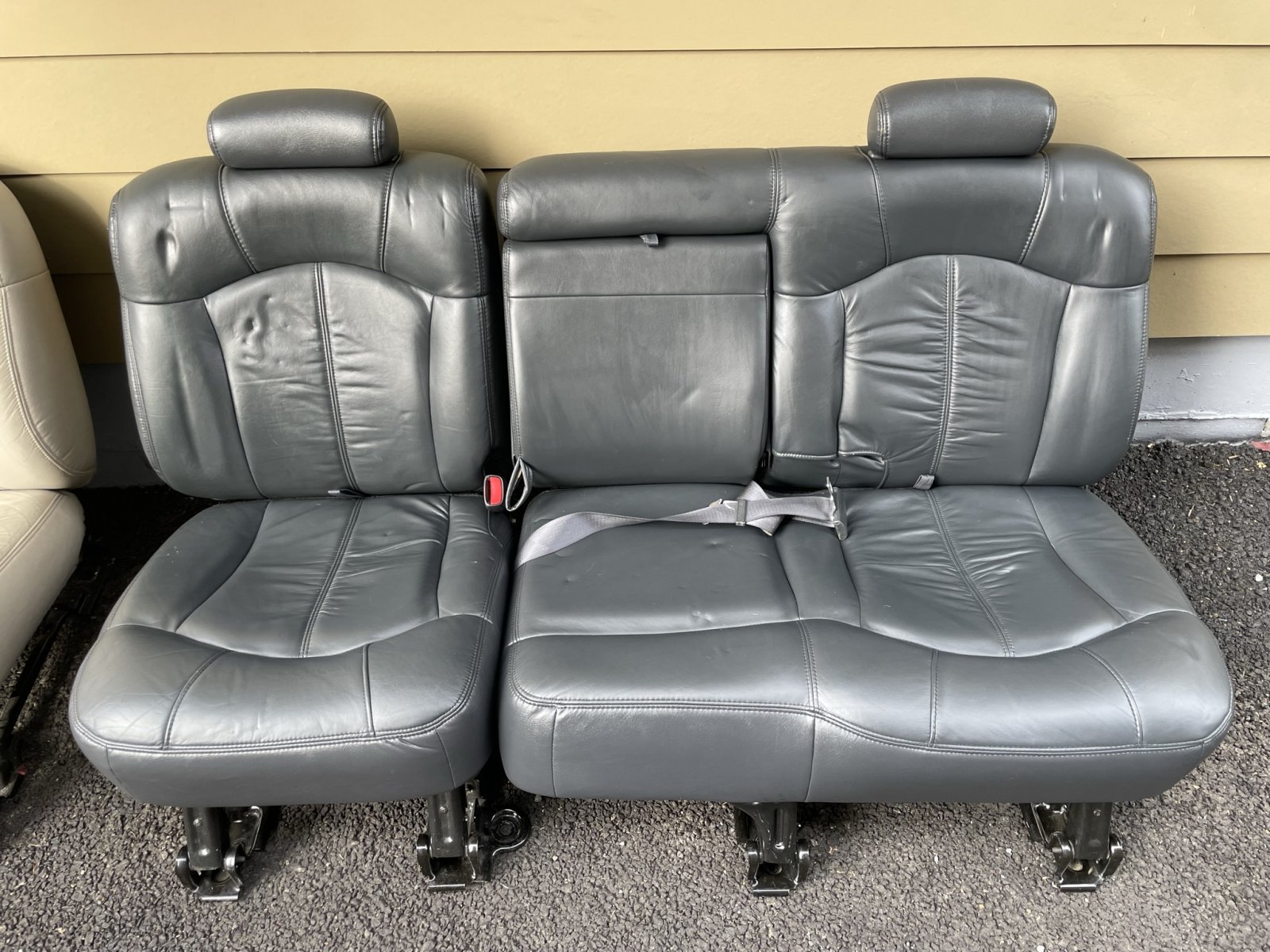

Drove out to Port Orchard on Friday to pick up some replacement seats from the junkyard. I found a 2002 sierra crew cab slt through car-part.com that had an interior with some life left in it.
The front and rears from the pickup are able to bolt into my yukon, but there are some significant differences. The 60/40 middle bench is different in that the back is not large enough to cover the 3rd row footwell and the smaller half seat does not slide foward on a track like the ones from the yukon do. But, both seat halves do fold down just the same.
The more significant difference for me is that the front sierra seats do not have side airbags built into them. My 2000 does have the airbags, so I've ordered some 2.2ohm resistors off amazon to hopefully keep the airbag light off.
My seats aren't in the worst shape, but the dirt is fairly caked in with a nice sheen over top of it. But, the front passenger seat is structurally loose and bounces around a lot and the drivers side has a broken armrest, so I'm mostly trying to address those problems.

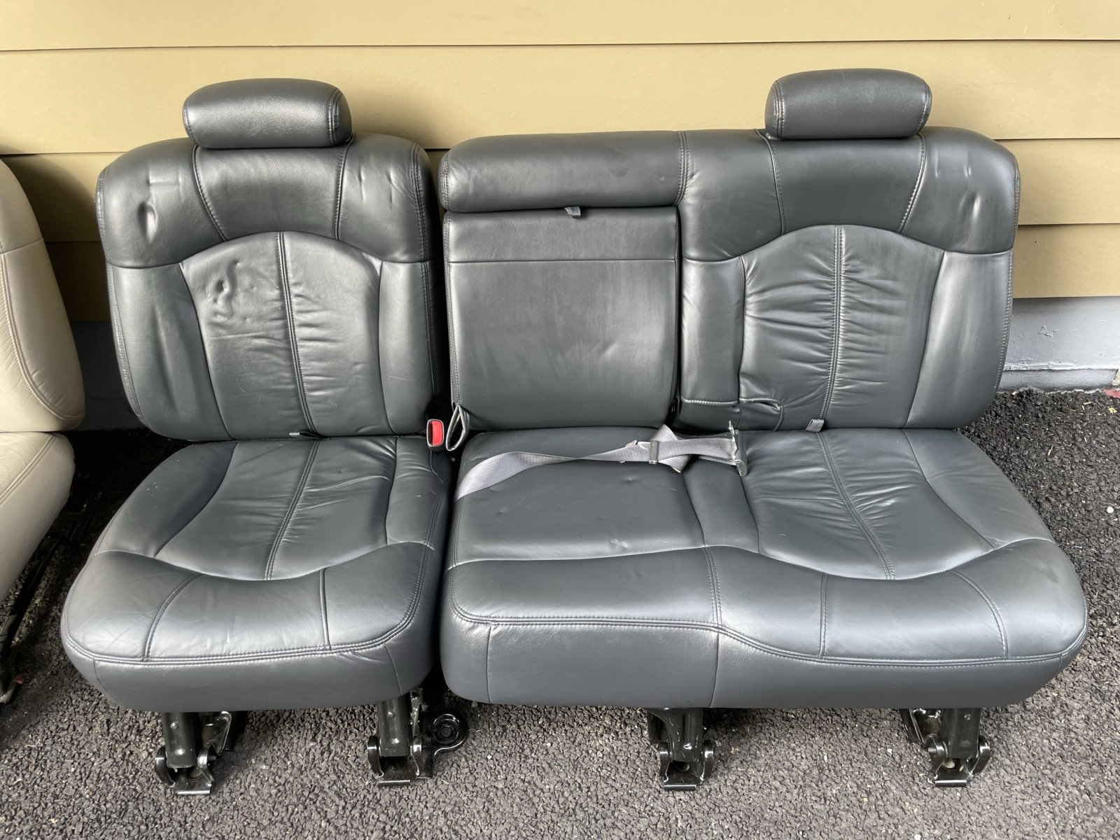

original yukon middle bench

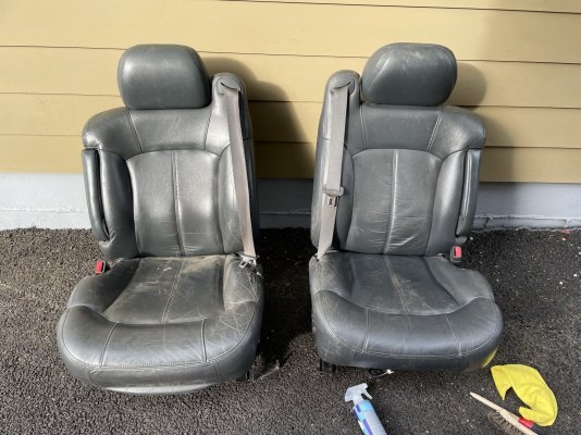

I spent Saturday cleaning up the middle bench and installed it this morning, though I don't have a picture just yet. Still waiting on the resistors to arrive before I can test out and possibly install the front seats. I have the fronts all polished up and ready to go in if so.
cleaned up sierra rear bench
The seats were $250 each at Kitsap Truck and Auto, which I think was a reasonable deal. So, check them out if you're in the area and need parts, lots of gmt-800 stuff in their yard.
fresh junkyard front seatsafter a bit of elbow grease

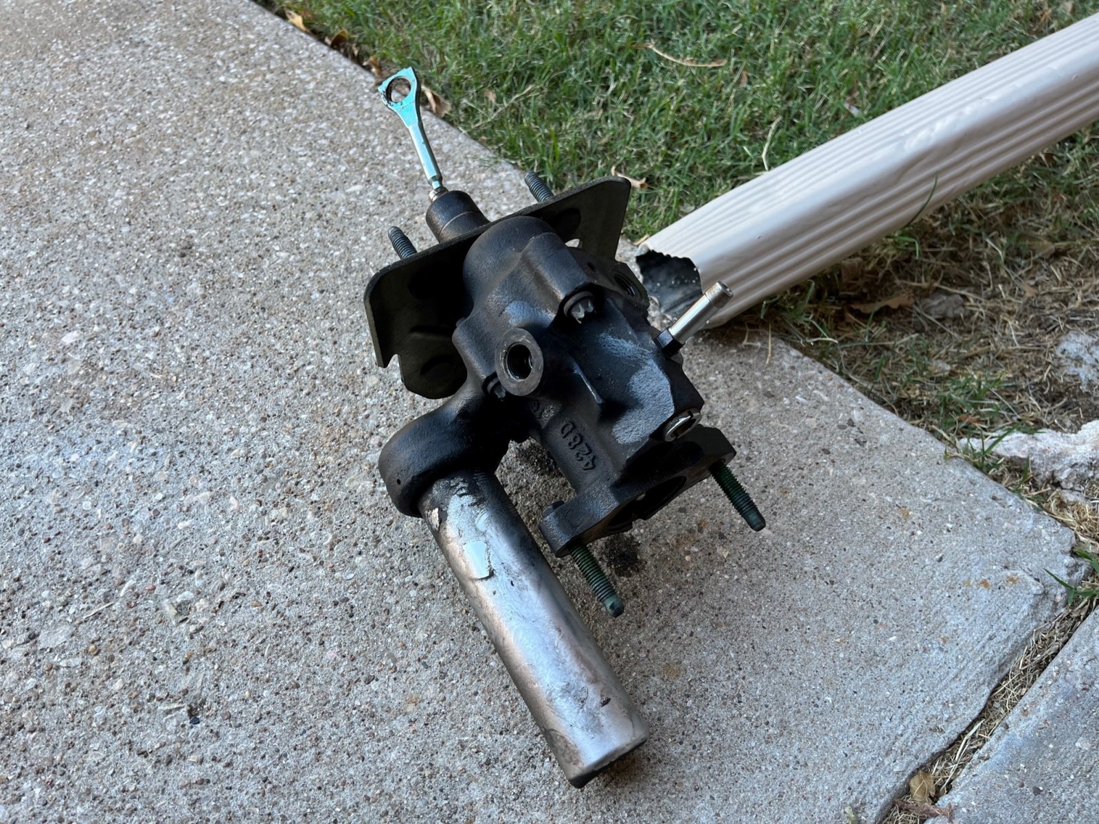

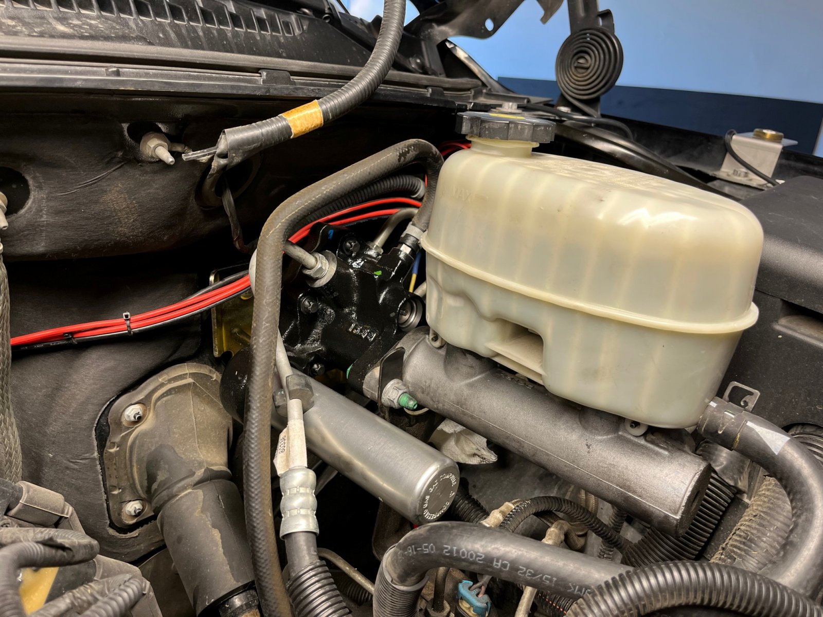

Friday evening I replaced my power brake booster. If it hadn't been for having to lay underneath the dash and remove/install 4 of the hardest to reach nuts I've ever seen, it would've been a 30 minute project. Instead, it took 2 hours. Still glad I did it myself since I paid $341 for the part from Amazon, versus $750 at the dealer plus whatever labor they would've charged me.
Sadly, there's no perceived difference in braking performance, but at least I'm not leaking PS fluid anymore.
Before:
After (I re-routed the soft line behind the hard line after I took this picture):
The old part after removal:

I’ve been wanting to replace my brake fluid reservoir ever since I did the same to the coolant overflow reservoir because it was so stained. I need to research if I’ll need to bleed the brakes though. Any idea if I will? I take it you didn’t need to when doing the booster?
Edit: I see the service manual states to remove the MC and then replace the reservoir in which case the entire system would need to be bled. I’m wondering if there’s a way to do it without but probably not lol.
What I did was outside the brake fluid system so I didn’t need to bleed the brakes, but what you’re describing, in my opinion, would require a brake bleed. I try to do a brake fluid flush once every two years, and a Motive bleeder makes it pretty easy for me.
Yeah I use a Motive too. It does make it easy. I just replaced all my fluid with Wilwood hi-temp fluid last year ‘cause race truck. :favorites37:And I have Wildood’s BBK. So I’ll wait until it’s time to change it again and do it then. I guess I better buy the reservoir so I’ll have it.
