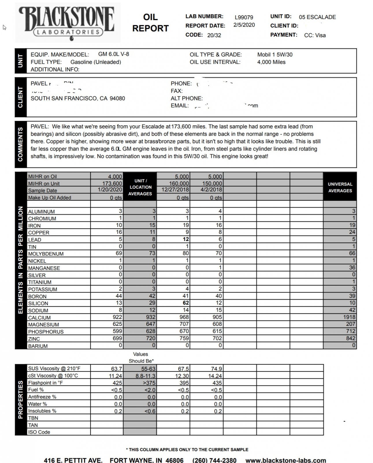

iddqd
Dec 18, 2017
224
651
San Francisco, Comifornia, USSA
Another oil analysis - so far so good.
