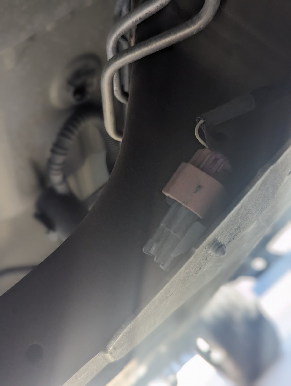

I checked underneath on my 2018 Prem and it has the connector for it in the same place as the Silverado's do
