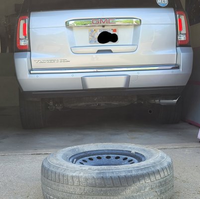

Added a 20" spare tire so it will work with the front Brembos. And yes a 275/55/R20 will fit in place of the 265/70/R17. You just have to make sure you move it so it doesn't catch on the heat shield on the way up.

Does it show more tire when looking at it from behind vs the factory spare?
