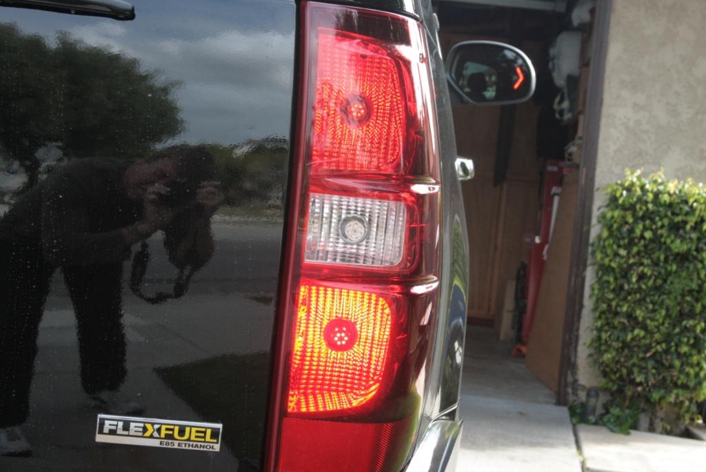

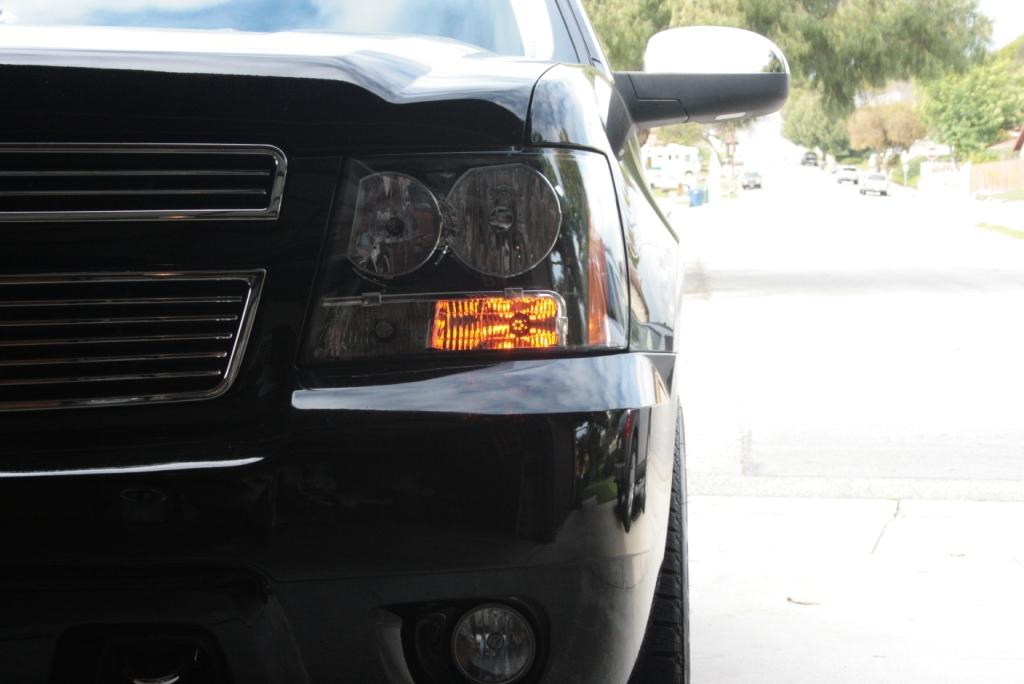

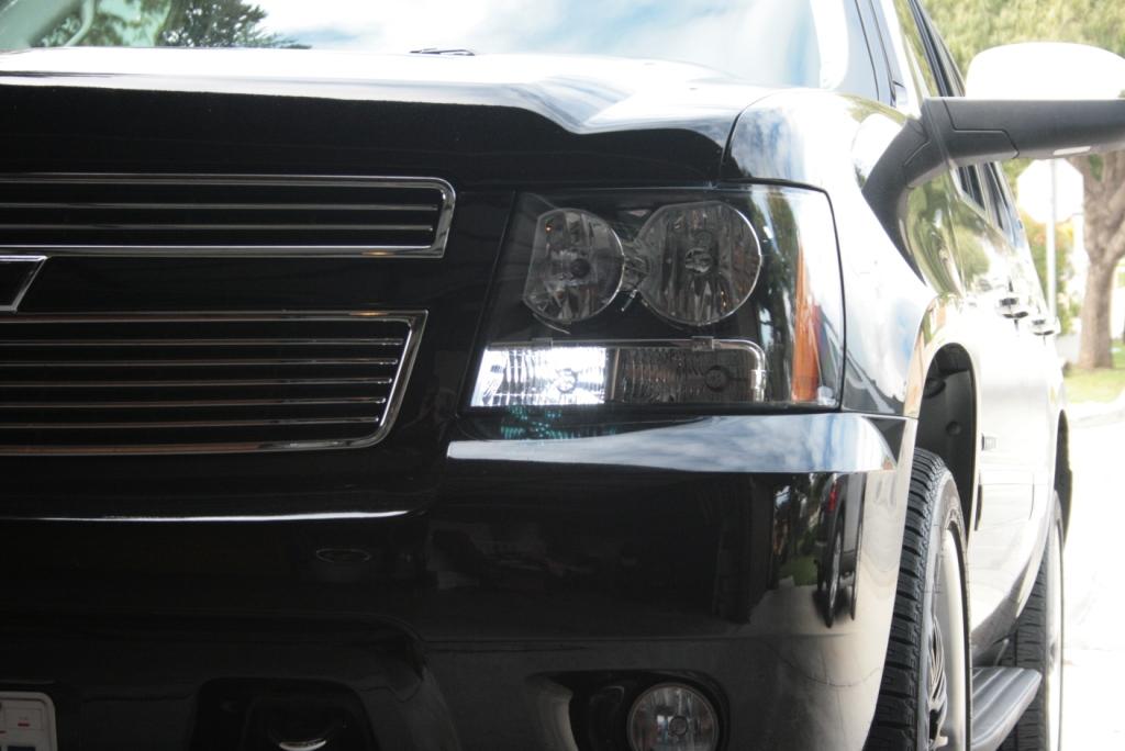

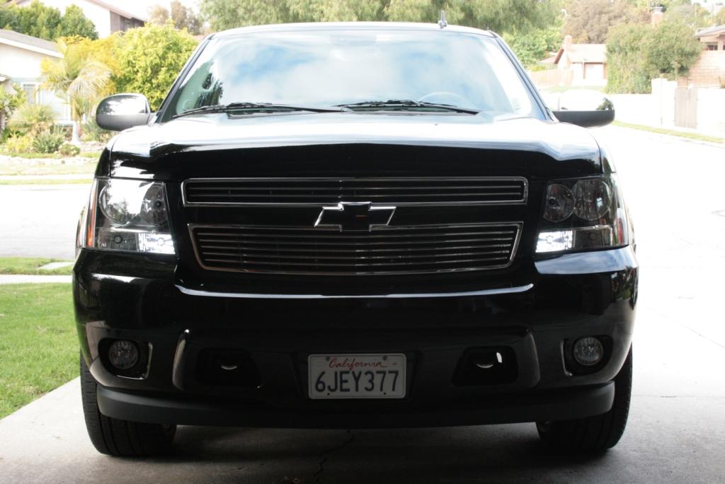

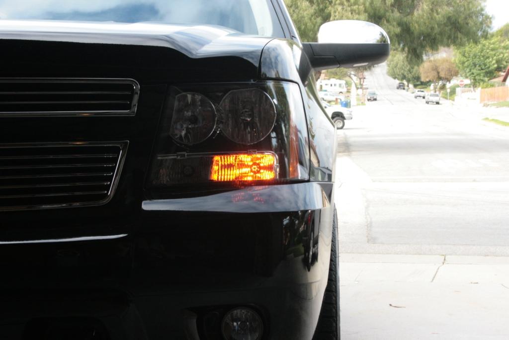

I used the 3157_27_MSMT_W for the DRL's and 3157_20_A for parking light/turn signals. I really like the LED's in the DRL's. The turn/park LED isn't as bright for parking lights but is fine for turn signals. I believe it's more a function of the small reflector area because the 3157_20_R's for the rear signals are really bright. Bad thing is pulling the whole headlight to get to the wiring to add the load resistors. No problem on the rear, but I took the whole bumper cover off to pull the headlights up front and mounted the resistors to the core support on the mounting plates they also sell. I'm now 100% LED, inside and out.

Here are the front and rear LED's.

Fast55 that looks good. Are the rear LED bulbs in the brake lights much brighter that stock?

Definitely brighter. Not like the G4's, but noticeably brighter than stock bulbs. You need 2 pairs, so it's about $100, but that's still half the cost of the G4's. The reverse lights are really bright. The only thing I think is a waste is the 194 LED's in the side markers. You can't really tell much difference from a stock bulb. I didn't put them in the puddle lights because mine are switched off (I think approach lighting is the setting in the DIC) because of my HID's.
