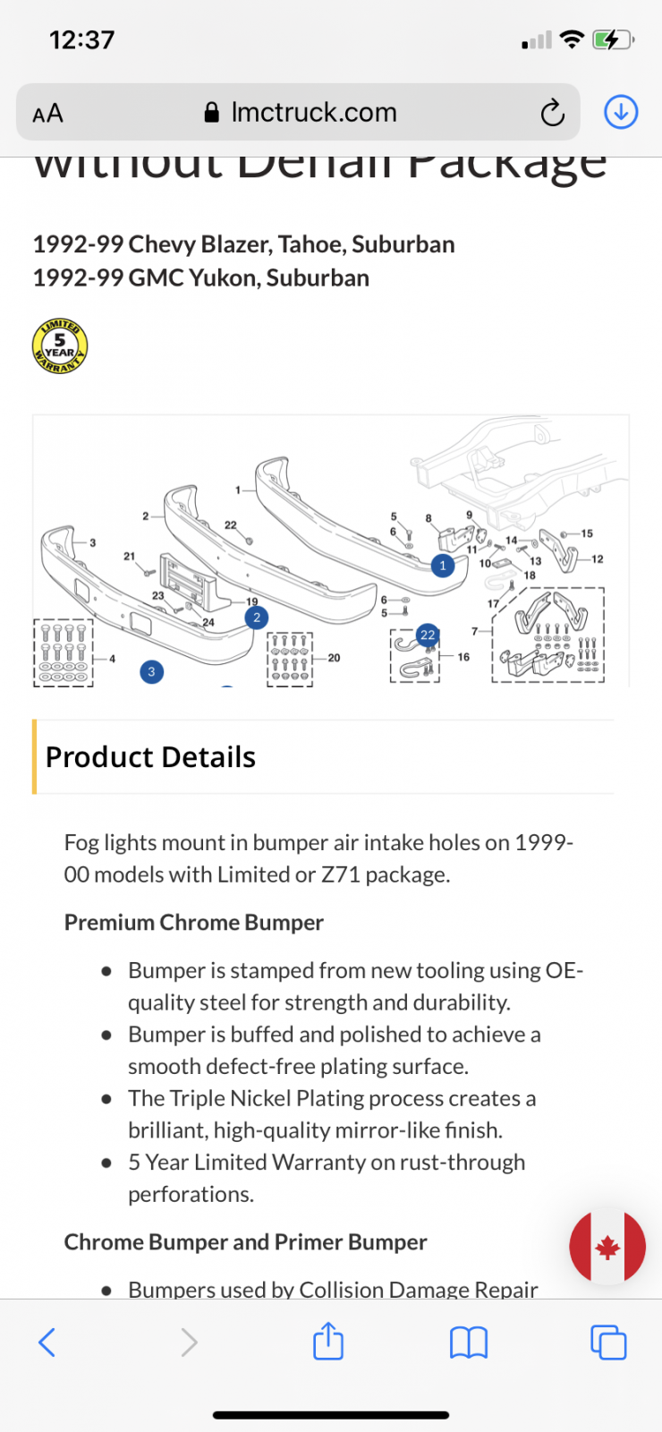

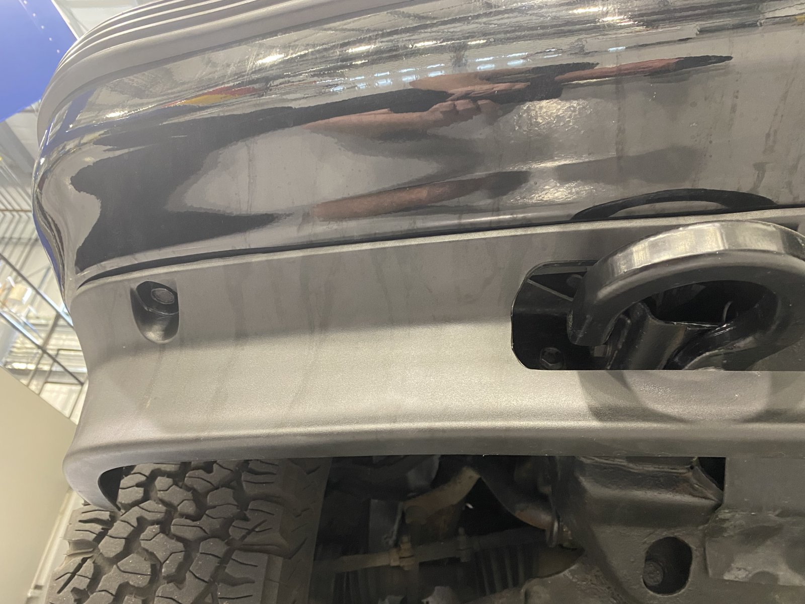

I don’t know how crazy you want to get, but I have seen OEM looking fog light installs on the bumper “3” in the LMC catalog. Or you could use the lower bumper attach bolt outboard of the tow hook location. You would have to modify your valence for the bracket and lamp.
