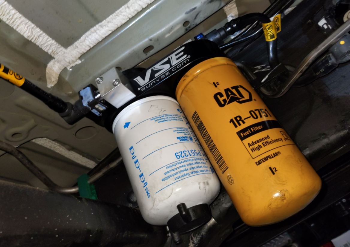

I installed mine last week, 24' Yukon. Fit was pretty good, seems like a quality product. The cat filter is 2 micron.
