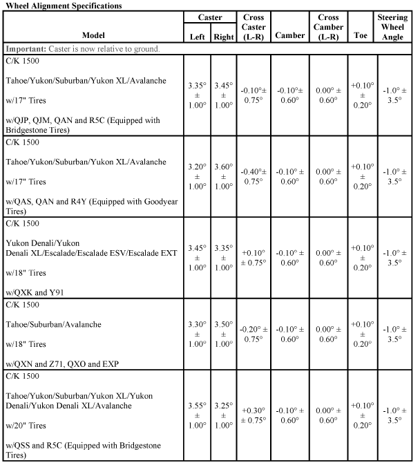

Looking at the chart, GM specs each side a little different and varying depending on the tire. I wonder why, for the crown in the road?
Not sure. Driver and gas tank are on same side. May have something to do with it. Control arms may be different length. I know the s10 was half inch shorter on ine side.

One of the many warranty issues I had with GM.... My '88 C2500 had different built leaf springs. ( The leafs were visually built different )
The dealership had no answer. The rear left was a tiny bit higher ( you couldn't hardly tell)...
I figured the issue was the Window Sticker showed the " Camper Special - larger fuel tank".
34 gallons. But the factory installed the standard tank of 28 & 1/2 gallons. ( GM ignored the defect - install ).....
So, the weight difference of a full tank was to have a slightly heavier leaf at the tank side (left).
So maybe there is differences from one side to another. ??

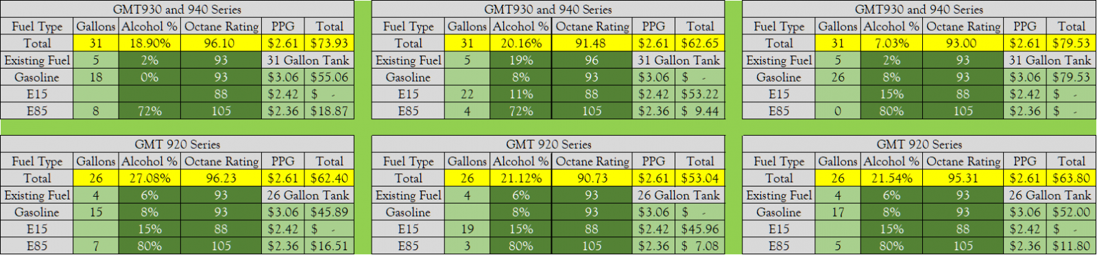

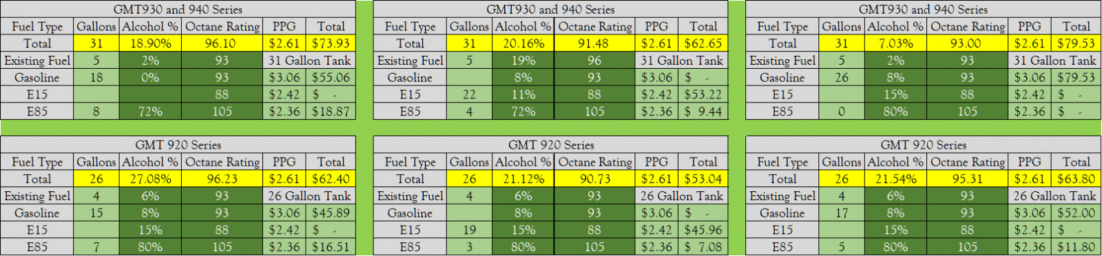

Anyhow, playing around with an excel calculator, it was determined that a 31 gallon tank with 8 gallons of E85 on board and the rest 93 octane fuel should yield an octane rating of 96 and an alcohol percentage of about 20%.
So I pumped in 8 gallons of E85 and 18 gallons of Sunoco 93 and the alcohol percentage settled down to 20%. Existing Mobil 93 was at 2%. I hammered it at a light and the trusty Tech-2 said there was 5 degrees of total knock retard still! Go figure.
Running with that mix is about $5 less per tank than a typical 93 fill at current prices. After this little experiment I'll run Unleaded 88 which is E15 plus some E85 which should come out around 91 octane (if starting with 93) and a 21% alcohol content. At current prices this mixture would give the benefits of 93 while saving $18 per tank of fuel.

James, explain that formula and why you went that route please.
I think he was referring to the content of the fuel tank..?
Ok. Made an excel spreadsheet that calculates octane and alcohol content depending on what fuel is used and also what the cost would be for each fuel and combined to compare potential savings. We know what the octane ratings for a given fuel are but ethanol content is never exact but try to get close and verify with scan tool. Does this help?:
can you upload that spreadsheet?
