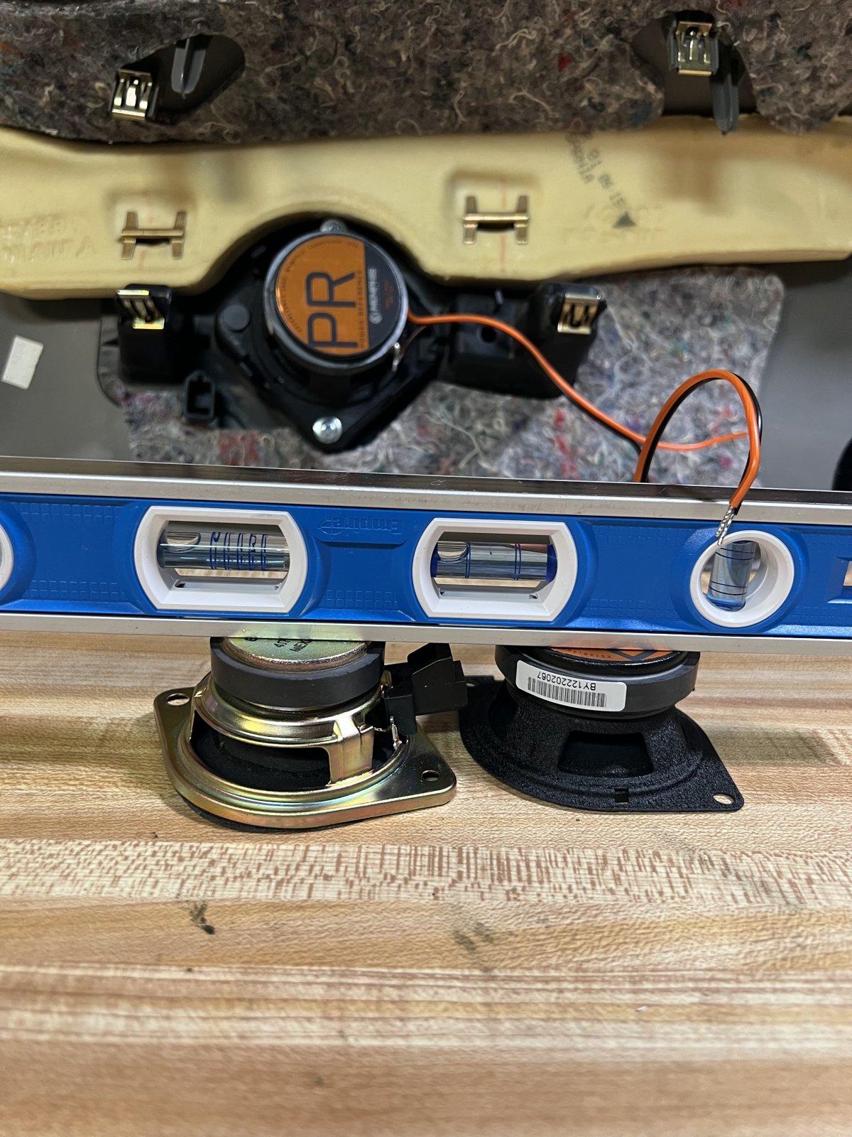

On those rear pillars, I upgraded 22 year old OEM to Memphis PR275. Installation was easy. I rotated the Memphis 2.75” speaker 90 degrees, then screwed the speaker frames to the base plastic with self tapping sheet metal screws. No bass vibration - I think this will hold fine but if not I’ll go back thru the outside with threaded screws and locknuts. Then I pushed the OEM black plastic plug back in the OEM top hole. The top of the plug captures the corner of the Memphis speaker frame, giving an additional third point of purchase. I used a 150 hz inline capacitor even though the amp sends a high-pass signal to the speaker, I figure this will future proof me. Replacing the two decade old speakers is crucial, in my opinion.
