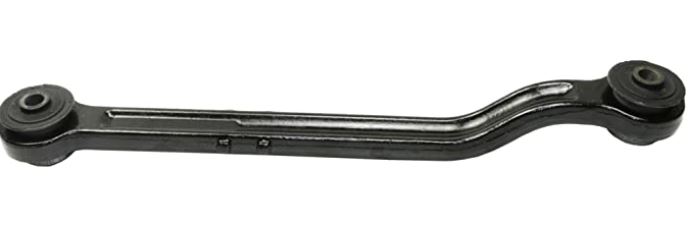

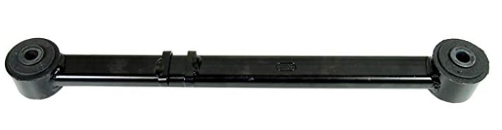

I am replacing the upper control arms/track arms (whatever you choose to call them). The issue I am having is there are apparently 2 different iterations of them. One that is straight, and one that is dog legged. I ordered the straight one, and the dog legged one was shipped to me.
The one on my vehicle is currently the straight arm. Now, on the GM Parts Direct website it says one pictured as the dog legged arm says "2nd Design", and when I click on it the picture of the straight arm pops up, lol.
Now, that being said the dog legged one is a dime a dozen, and the straight a little harder to find. Are they interchangeable?

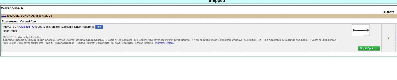

Yeah, the Mevotech is actually the one I have pictured above.

@lamerem As you can see here for the rear: the lower control arms are straight and the upper control arms have the bend in them. Are you saying that on your Tahoe your rear uppers are straight?
Are you talking about the track bar? It runs parallel to the rear axle from the driver side axle to the passenger side body mount.

I just changed all four arms on my 2005 Z71 and the upper arms were dog legged and the lowers were straight. I call them "locating arms" because it locates the axle to the frame and the track bar is there to control the track of the axle from side to side. At RA they are called control arms but identify as rear instead of front.
As I look up the arms for my rig and yours, the part numbers are the same. The AC Delco lower straight arm is 45D10160 and the AC Delco upper dog leg arm is 45D10231

Yes, my uppers are straight as the one on the right of the pictures I attached. I climbed under the truck last night and verified, and was told by the dealer that some trucks came with straight, and some dog legged. There is a design one, and design two. Not sure which one is which.
I ended up ordering the Mevotech straight arms, and will install this weekend. I have a small clunk in the rear right, and the uppers are the only thing not new. Here's to hoping...
