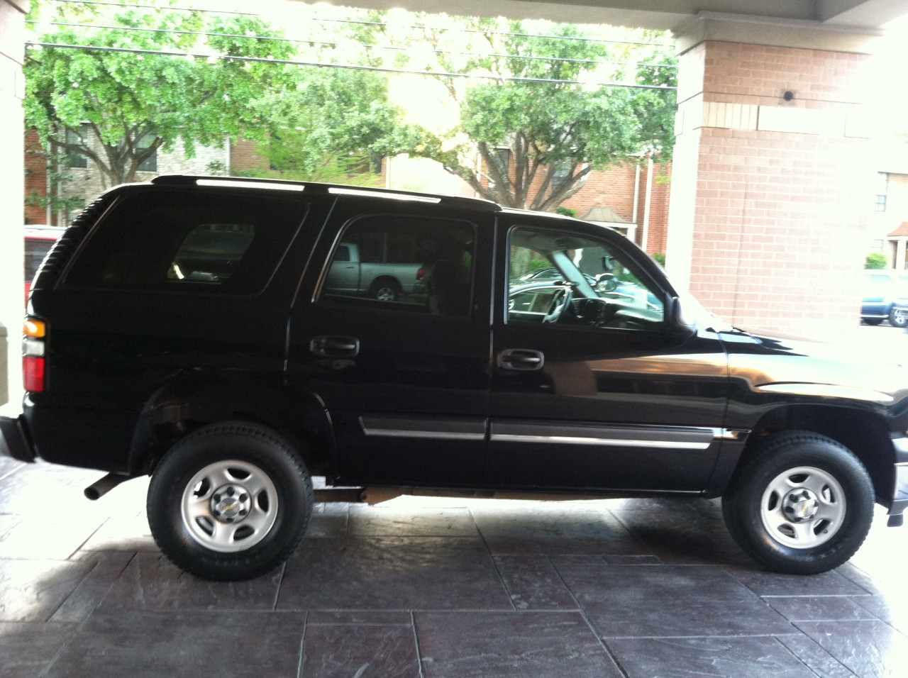

*It appears that the tahoe has a rake? Is this part of the package or what? How would I go about leveling it out the easiest without sacrificing any integrity (I did buy it specifically for towing). I don't believe it to be aftermarket as this was a one owner government car.
*If the car is raked and I do have some way to level it, would the trailer hitch depicted in the photo need to be moved up? It appears to be lowered? Or maybe I'm mistaken. Looks to be lower than my ex 07 silverado ltz hitch was
You have a bad rake. It depends if you want the rear to go down to match the front, or the front to go up to match the rear.
depends on the answer above

Could you elaborate on what a "bad rake" is? bad as in screwed up or bad as in massive. And its definitely not from the factory?
Do you know a super rough ball park estimate on getting a rake like that fixed?
Rake is your rear being WAY up, and the front looking about stock. It's never THAT bad from the factory. I bet they towed something major with it, and loaded it down to almost factory height. That could be why you have double hitches as well.
If you want to go down to level it with the front, you could get some springs for $200 or so, maybe $150 used. you might have to swap out both rear shock that would be another $150 or so

thats def not a stock rake, i've got a set of z71 coils laying around, idk what they did to make that sit so high, but i've gotta assume they swapped the coils and probably put a longer shock on
x2
at least stock springs will get you close. that's not just shocks. You'll need both shocks and springs

I also just found out that the front shocks are RED and the rear are BLACK if that adds to the mystery any. No detailed info yet tho
---------- Post added at 10:53 PM ---------- Previous post was at 10:48 PM ----------
anyone with a build sheet know if the springs that came from the factory are the same as a z71?

if its got the z71 package, stock it should have come with the slightly beefier coils
and i'm not using these coils i got, not sure what they're worth but if you wanna buy em and pay shipping i'm sure we can work something out
