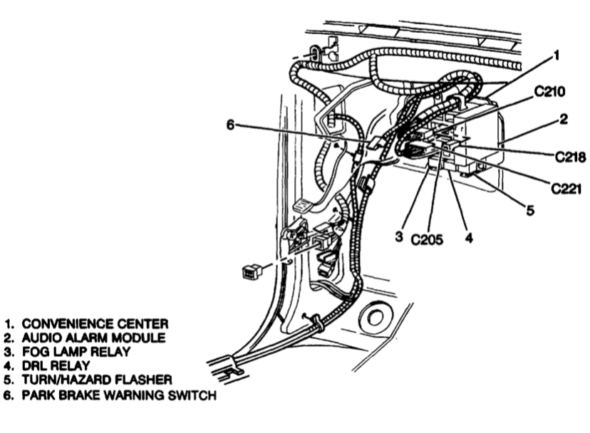

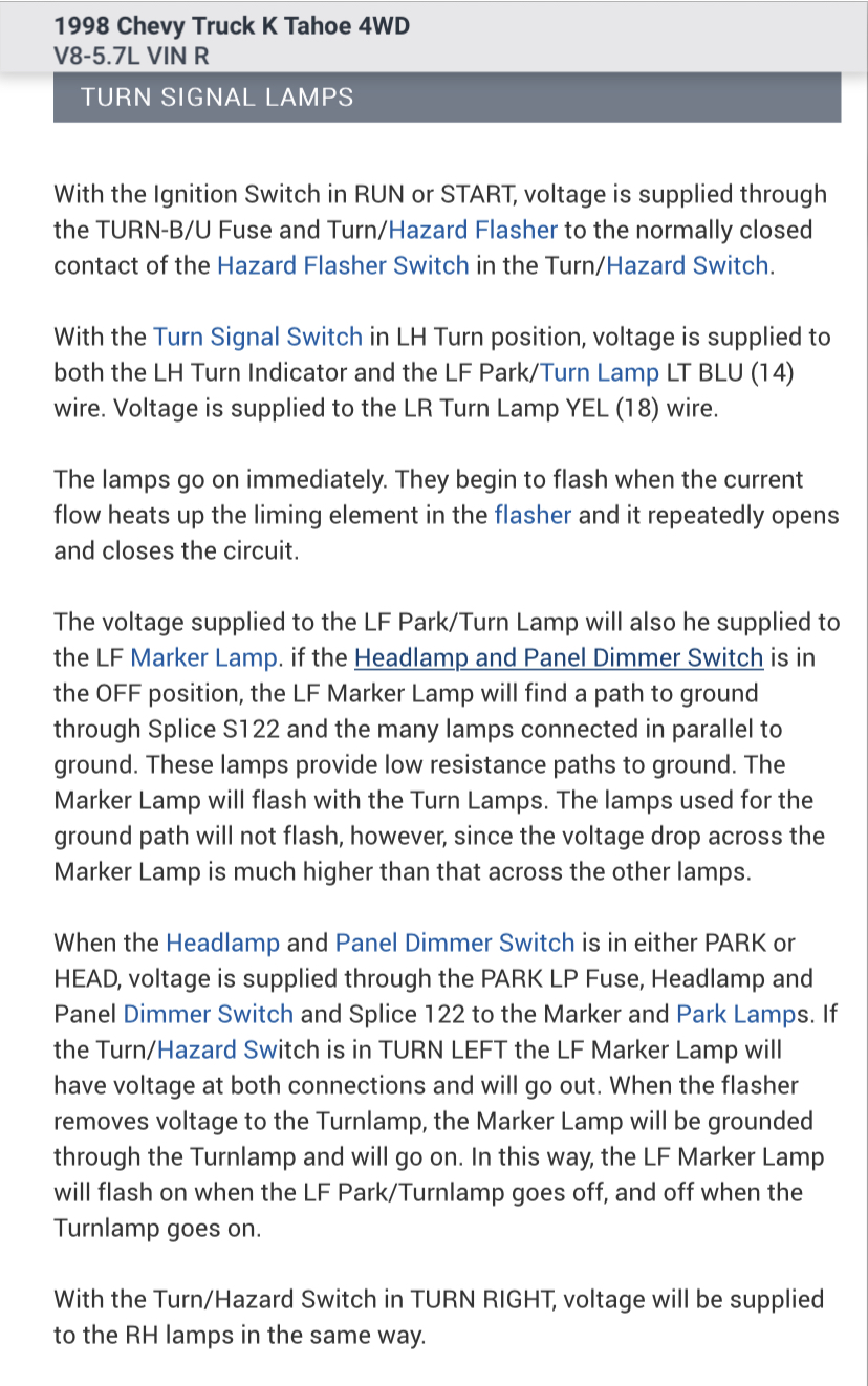

Flasher is plugged into the convenience center by the parking brake. Here is how it works, (note the third paragraph) but you could double-check by checking the voltage on the yellow wire (left) and dark green (right) at the taillight connector so see if voltage is constant with the turn signal activated- it shouldn’t be.
