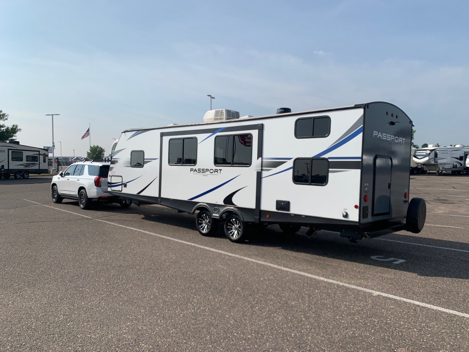

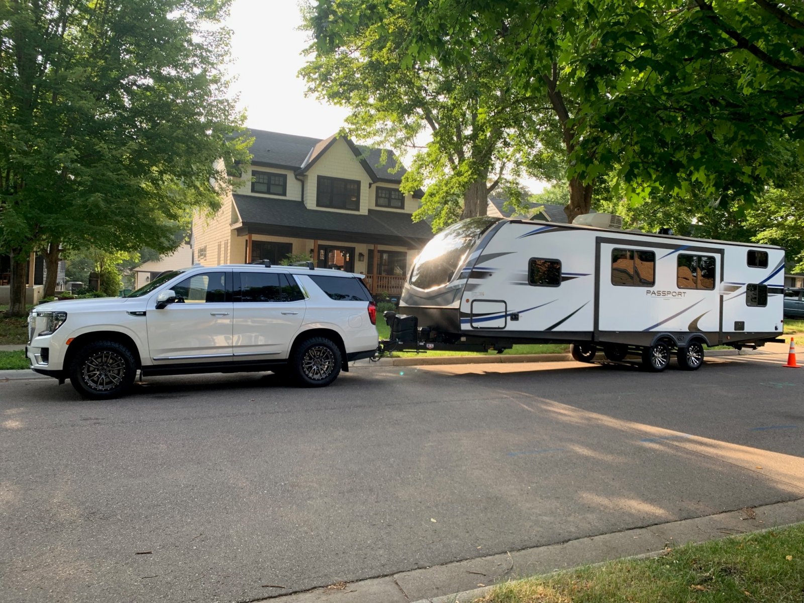

Hi all - quick update on the camper situation. I ended up finding a camper a little more in the weight range for the Yukon to pull, so ended up with a Keystone Passport GT 2950BH. Dry weight for the rig is about 6200lbs with around 700lbs of tongue weight, 34' long and I am running an E2 Trunnion Anti-sway/Distribution Hitch.
Finally made the maiden voyage this morning to lake about 100 miles away and it pulled fantastic! I did about 65 MPH the entire trip and it felt great towing. I did have it fairly well loaded with gear and a full fresh water tank as well. Very happy with the towing capabilities of this rig. The pictures are of the truck prior to starting it and letting the air bags fill up completely so the rear end did come up even further from where it was when parked. AND that rear angled photo really makes the trailer look much bigger than it really is LOL
I did forget to mention that my Yukon has the Max Towing package as well which I am sure helps with cooling, etc.
Appreciate all the input.
Looks great! Sitting just like it should. Which hitch did you end up with?
