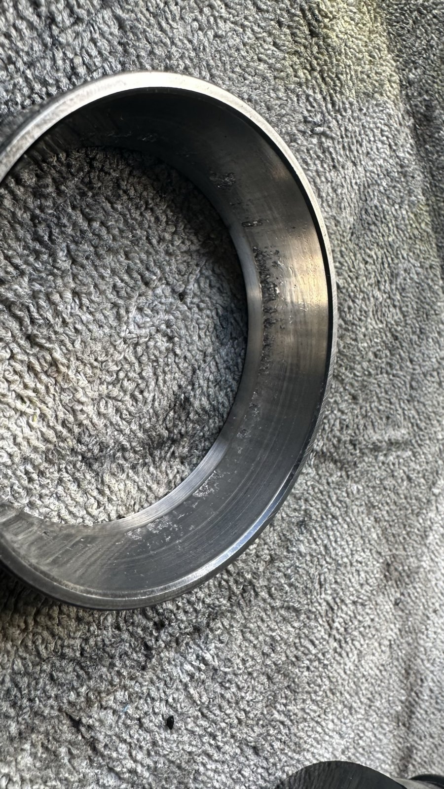

One the the races in the dif looked like that.
Could this be the source of the problem?!

Actually the bearing didn't even look that bad.
The bad race is from the carrier bearing. The two on the pinion look like they are alright.
Yet I will still replace all of them, of course.
I couldn't see the surface of the races before disassembly, so there was no way to tell just by visual inspection.

I had the same symptoms on my 99 Sierra Z71. It was the rear axle bearings. Pitted just like yours. Had the noise for close to 2yrs before I fixed it. Im lazy like that.

With Glitter in the Rear end oil consider changing Wheel Bearings also while it's easy.

I put new wheel bearings in already. The plan was to assemble everything this weekend. Unfortunately the pinion seal that came with the rebuild kit didn't fit... :mad:
The old bearings had to be grinded and hammered off the pinion and diff carrier. The new ones came on easy with a regular small shop press.
Everything's ready for installation, I'm just waiting for the seal.
