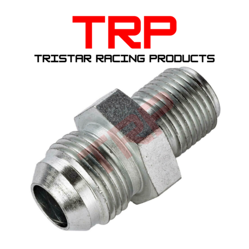

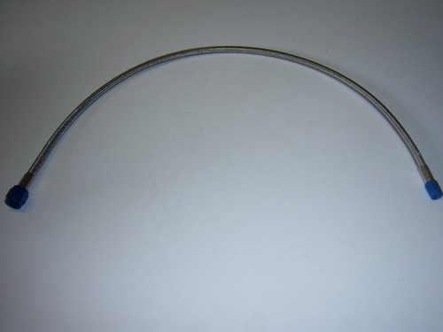

I would replace that line they cut and get some quick connects and AN lines to the external cooler, this will eliminate any possible leaks in the future, I had worm clamps on mine and had the same issue
I bought 2 of these
and 2 of these to fit a true cool
and 2 of these (quick connect factory size), same as what is used on the radiator
and 2 of these
I bought 2 of these
and 2 of these
Are you saying replace the lines that run back to the tranny?
