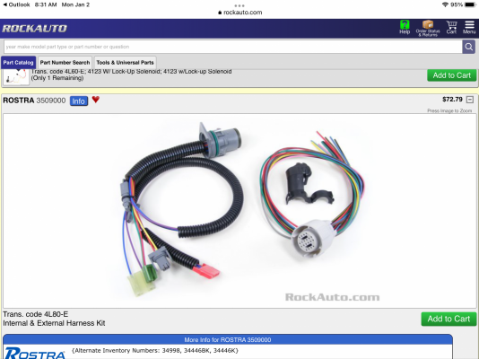

You can get both the internal transmission harness complete or for the vehicle side you can buy the connector with pigtails on it and you have to cut and splice the wires. They have butt connectors now that heat shrink around the wires for a water tight connection. I solder and heat shrink my wiring but the butt connectors are easier.
