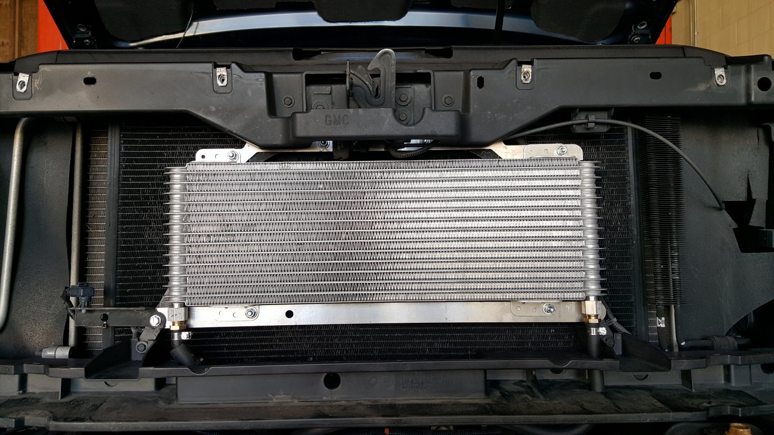

Installed a Tru-Cool 40k trans cooler this morning. Even though I have the tow package, no trans cooler included. Thanks GM. Anyway, all done, no leaks and way cooler trans temps now.
2009 yukon xl.
@Tractoman where did you run the lines? I installed one in my 04' Silverado but followed a write up to use factory lines. Haven't seen much for GMT900s w/o lines. Thanks!
