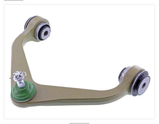

Are your upper control arms topping out on the stops over bumps?
Just to update you this is what my mevotech ttx UCA look like at ride height I don’t think it’s an issue with the UCA?
