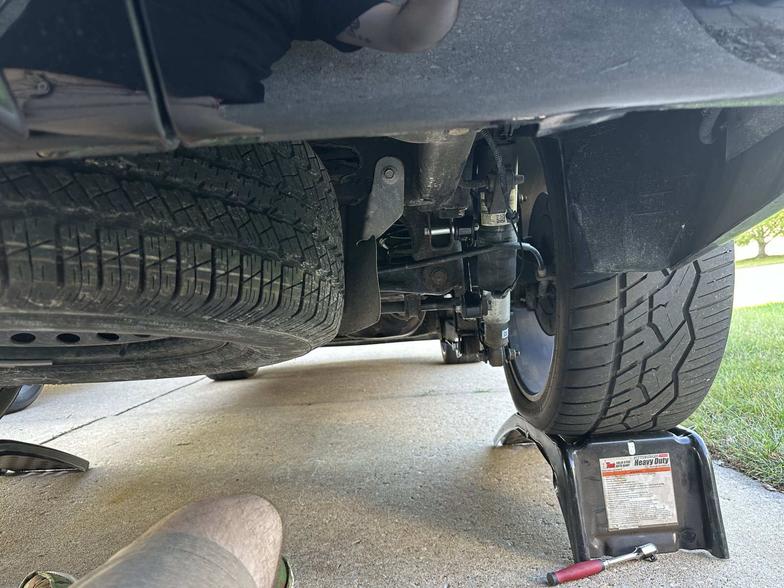

After some conversation with @iamdub , he asked me to post these photos here to show that there IS an alternative for 2007-2014 Tahoe / Escalade / Yukon / Suburban rear sway bar links. This is part of the Trekline 5” rear drop kit:

I see what they did. I like the idea of having the bushed ends inline with each other versus the Z'ed offset design of the DJMs- the joints are in compression and tension versus shear. If I manage to break mine, I'll keep this idea in mind. Or make a stupidly beefy Z.
I'll probably buy a set of Tony's just to see what they're all about. I like the idea of spherical bushings vs static bushings.
