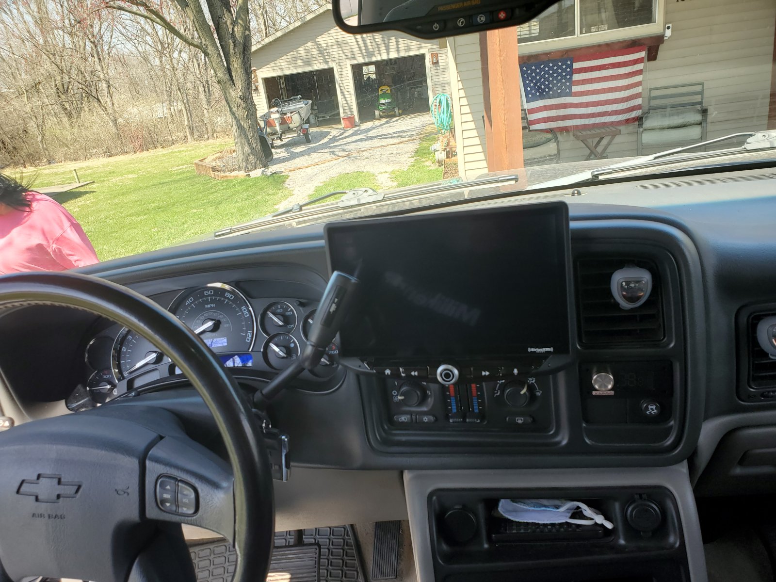

When its in park it does, but not when driving. I will say also the shifter never touches the screen itself. But hardly ever am I trying to do much with the screen in park unless I'm doing a demo for the stereo. It is a floating mount, I could mount it lower or make a custom mount for it but then I'd lose my access to my HVAC controls. Maybe later on I'll relocate them to the glove box and permanently fix the screen to the dash.

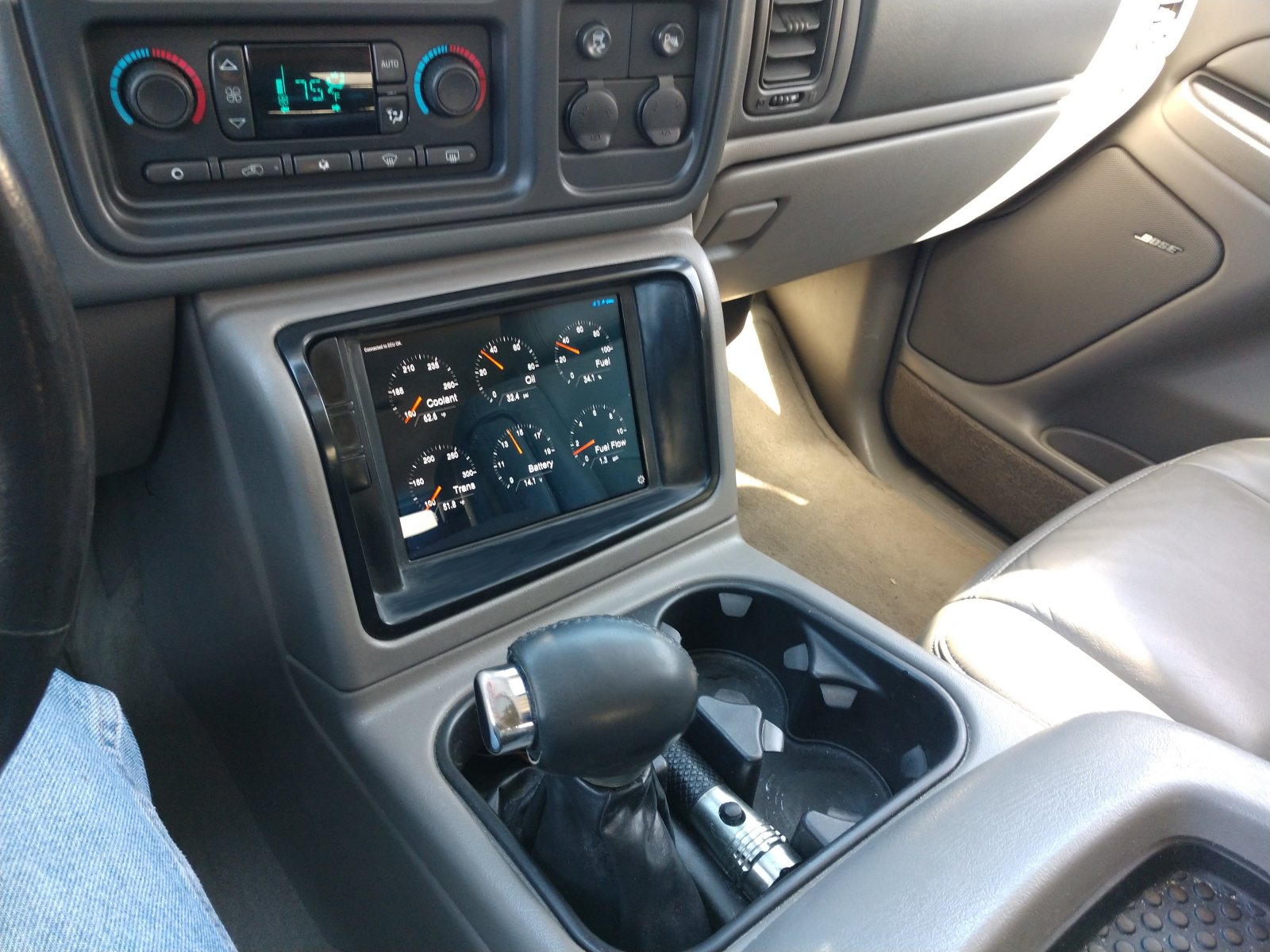

Here is how I installed an 8 inch Galaxy tablet in my 2005 Tahoe. Besides the usual things that you can do with the tablet, I have also set it up to display a reverse camera, and connected it to OBD2 diagnostics and monitoring. Music from it is fed into the factory stereo through the RSE aux in.

How do you have a floor shifter that looks like a trail blazer ss

It is from a Trailblazer. I fabricated a bracket to hold it in the Tahoe console and rerouted the shift cable from the steering column, the cable connects directly to the Trailblazer shifter. I did have to modify the subwoofer box a little to make space for the shifter. I also replaced the column cover with one from a pickup to get rid of the shifter hole after removing the column shifter.
