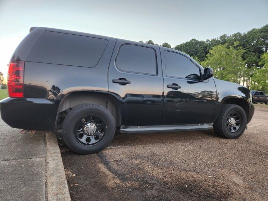

I thought the only difference in the ppv suspension was lower springs in the rear and “lower” struts up front but I may be wrong I went from nose diving hard to leveled I had to crank em down a bit type way cause I diddnt have anything changed in the rear
So it should work

My 09 Tahoe is an SSV. It was once a police vehicle. It has the ZW7 (premium smooth ride). I want to replace my rear shocks. I can't find any at decent price. I've heard that some companies make a conversion kit. Does anyone know of a quality company? If I just bought Z71 springs and shocks, would that do it?

Just get a set of the yellow or silver Bilsteins and be done with it if you care about the light on the dash order some dummy sensors for the air ride or whatever system it had on it
