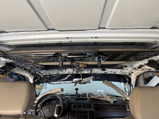

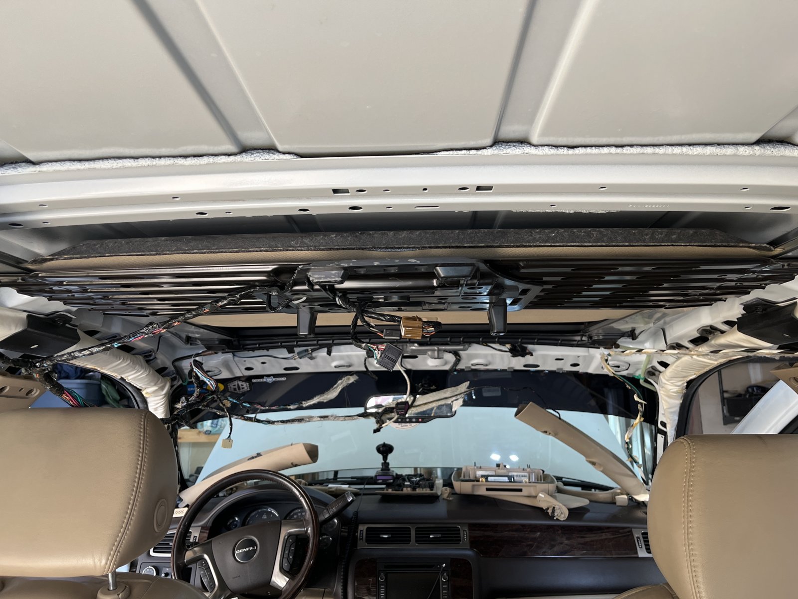

So I’m finally doing my starlight headliner and I have successfully gotten the first part of the headliner out. but now I would Like to hopefully remove the sunshade to get lights on there as well but I can’t figure out a way to remove it. 09 Yukon Denali any help is appreciated!image.jpg

So I’m finally doing my starlight headliner and I have successfully gotten the first part of the headliner out. but now I would Like to hopefully remove the sunshade to get lights on there as well but I can’t figure out a way to remove it. 09 Yukon Denali any help is appreciated!View attachment 394839

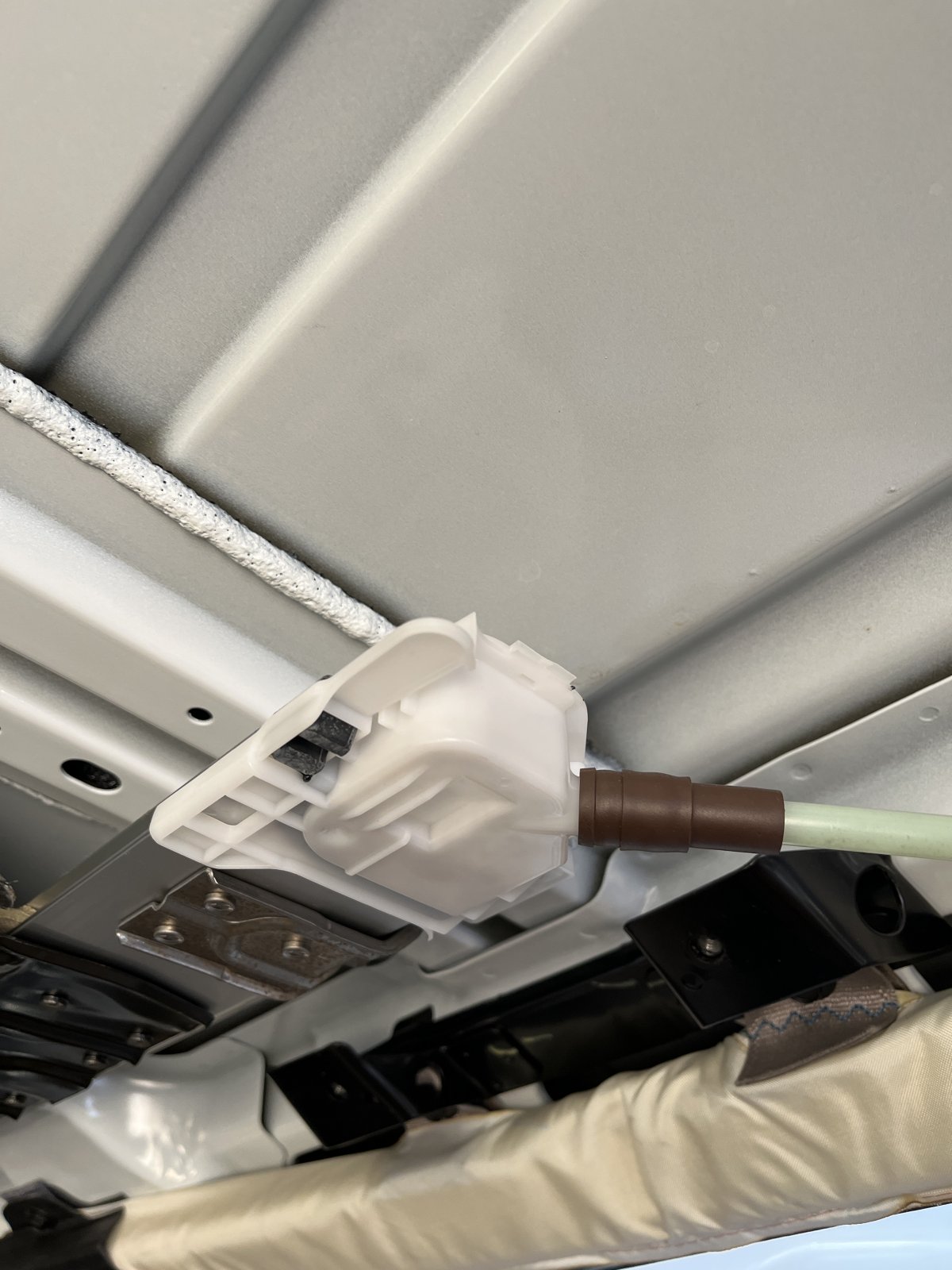

I haven’t been able to figure out the sun shade either and a lot of Tahoes I’ve seen had the lights around the sunroof but not in the sunroof
Side note though it wouldn’t be a bad idea to throw some insulation on the roof before you install the headliner back in to help with the heat this summer
plenty of videos on YouTube on doing this

Yes those are drains. You have to unbolt the 6 screws. Having a second pair of hands is highly recommended. I myself didn't have that hello but I managed. Changed headliner to black along with the cover. Make sure to take advantage of the unit being out to do some much need maintenance. Grease..
