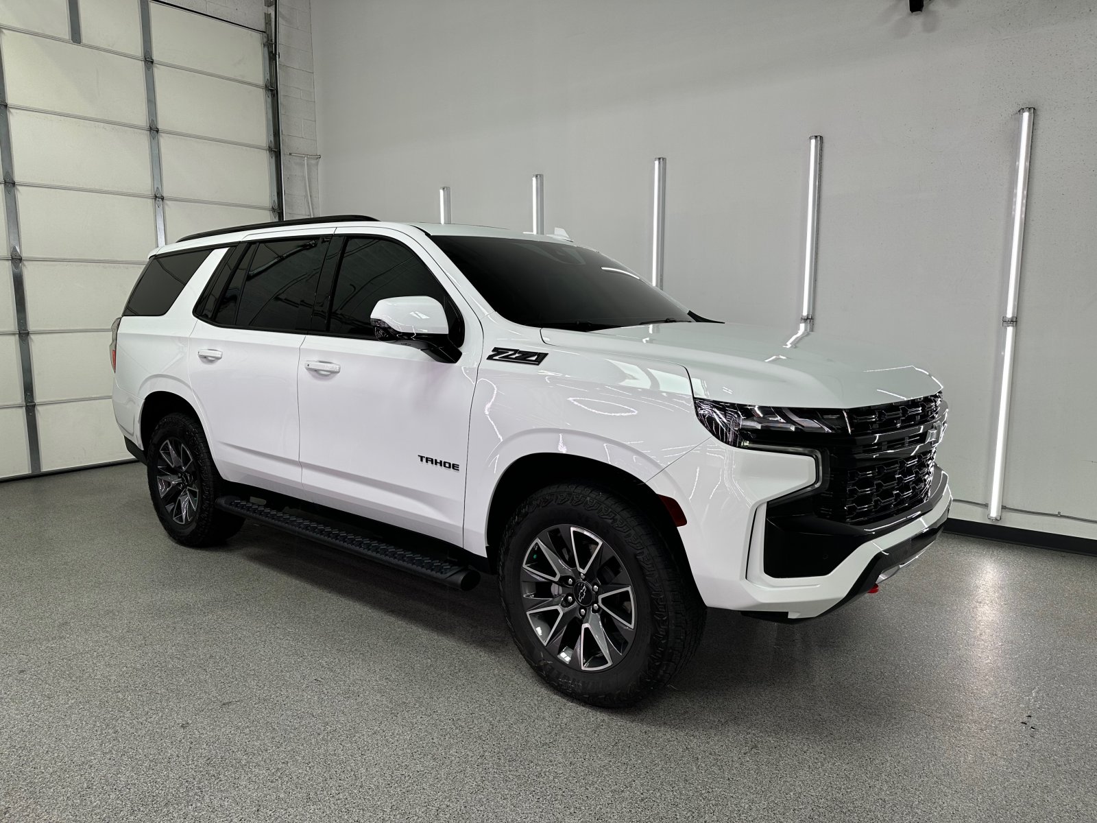

Looks great! Where’d you get the badges?
eBay - just make sure you get the oem one not the junk ones that are just stickers.
I ran a piece of painters tape across the bottom of existing emblem. So it would be perfect then marked where it started and stopped.
Heated the old emblem with a hair dryer, fishing line and it was off. Then my son ordered an eraser thing that goes on the end of a drill. It was amazing to remove all the excess sticky material. I was done start to finish in 15 minutes.
It’s silly but on the white it completely changed the look.
This is stock:
