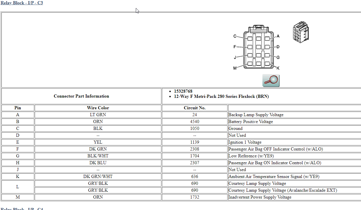

I haven't gone too far in research, but here's the left rear door connector views taken from a 2002 MY. Not sure where upstream you'd source the wires from. For my footwell lights, I used the courtesy lamp feed near the MBEC in that set of connectors. I'm guessing the right side is what you replaced and you need to run wire for the left side. Let me know if you need the connector view for what is on your truck for comparison.

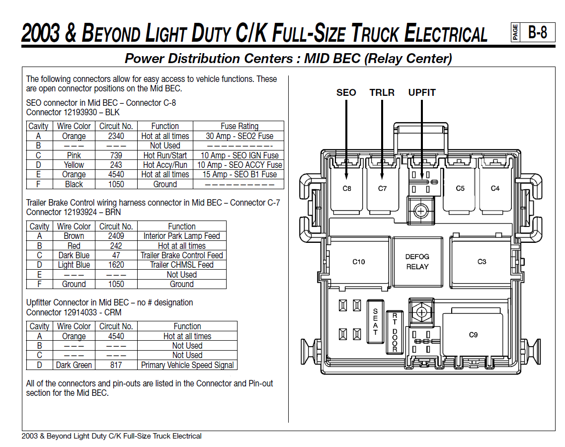

The pic is for the courtesy lights in the rear doors. The 03 likely has several spots empty inside that jamb harness.
For my front footwell lights, I tapped into C3.L in the Mid BEC.
