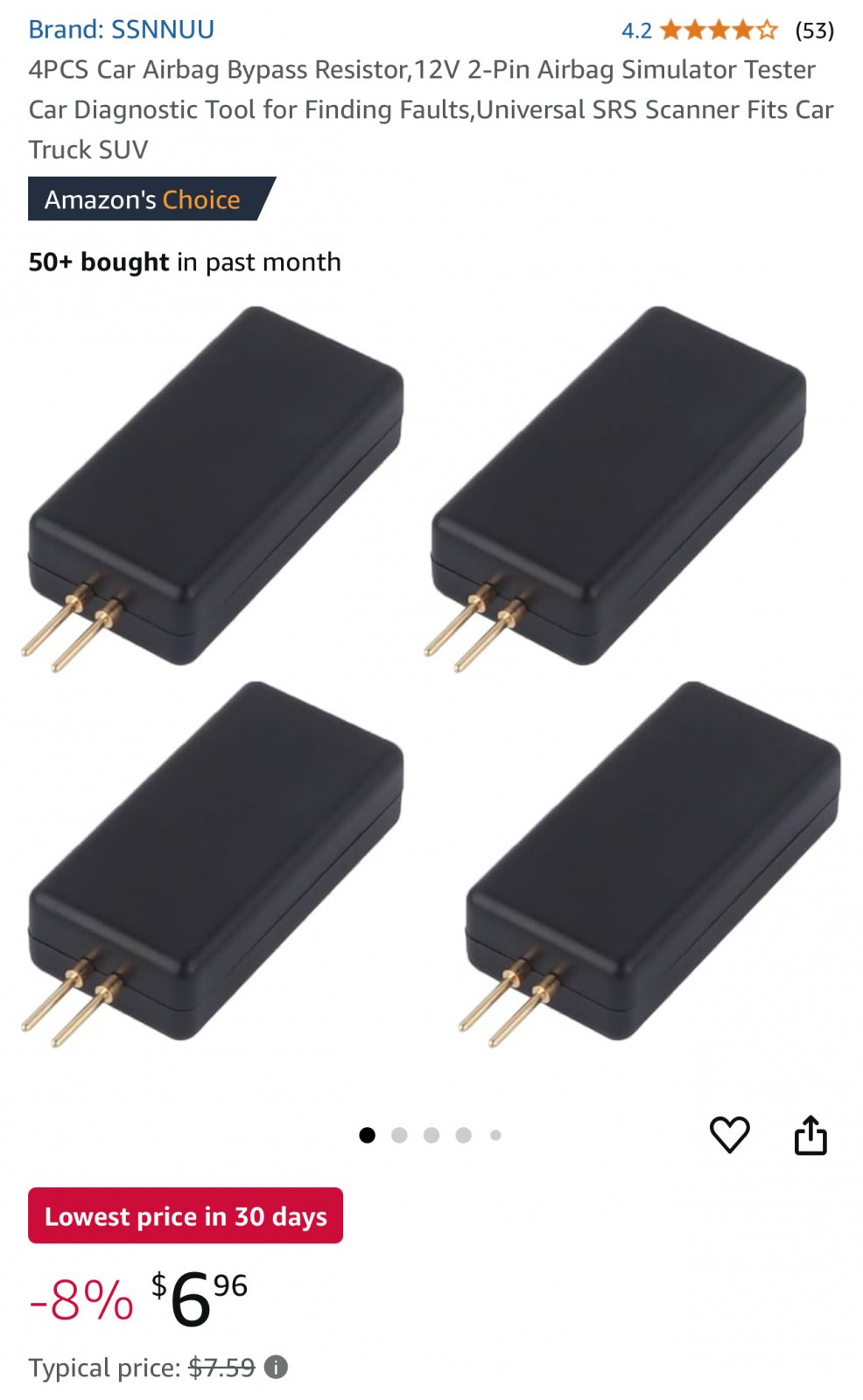

Question. What was the process for adding the resistor? What size was it? What did you need to do to clear the air bag code after installing the resistor?

I believe I removed the negative cable from battery, and then you unplug the airbag and plug the resistor into its place, and connect the battery and the system works and nothing needs to be cleared. The resistor acts as the airbag. See image, I got one of these and they plug right in.
Here is the link of the one I bought: https://a.co/d/0FD5jwz

Great. Thank you. I pulled cloth seats with bags and replaced with older non bag seats. I'll pull the cable and pop these in,
You are welcome! You just need to plug one of them, the drivers seat has the extra side-airbag on the side between seat and console.

You didn't by chance ohm one of those out to see what value it is, did you?
Per amazon reviews/listings they should be around 2.2ohm, I did not measure mine, don't have measuring tool, but I still have one resister left as I bought a pack of two. I will ask my brother who is electrician if he has measuring tool and will try to measure it.
