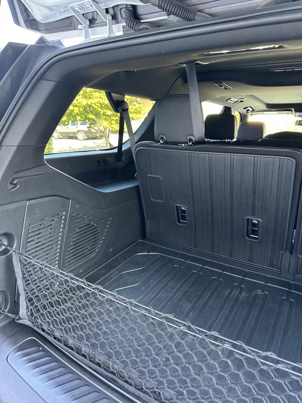

I could not find one piece all season mat for Suburban/YukonXL with 1st row bench, so I bought a set for Silverado 2019-2022 and it fit, it's a little lose on the hump, but works good.
I also added a clip to front Silverado one piece all weather mat because only drivers side had clips and the mat didn't have anything for front passenger side and it moved around (the oem front passenger side does have a clip, so I only had to add the female portion of the clip to the Silverado mat. The kit came with extra replacement clip so I used one and installed it and now the mat holds good on passenger side. (see pic)
I bought a set of "OEDRO Floor Mats" on Amazon for Suburban/YukonXL and also a set for Silverado to use the front mat from pickup truck: "OEDRO Floor Mats Compatible with 2019-2022 Chevrolet Silverado 1500/Sierra1500 Double Cab with 1st Bench Seats"
