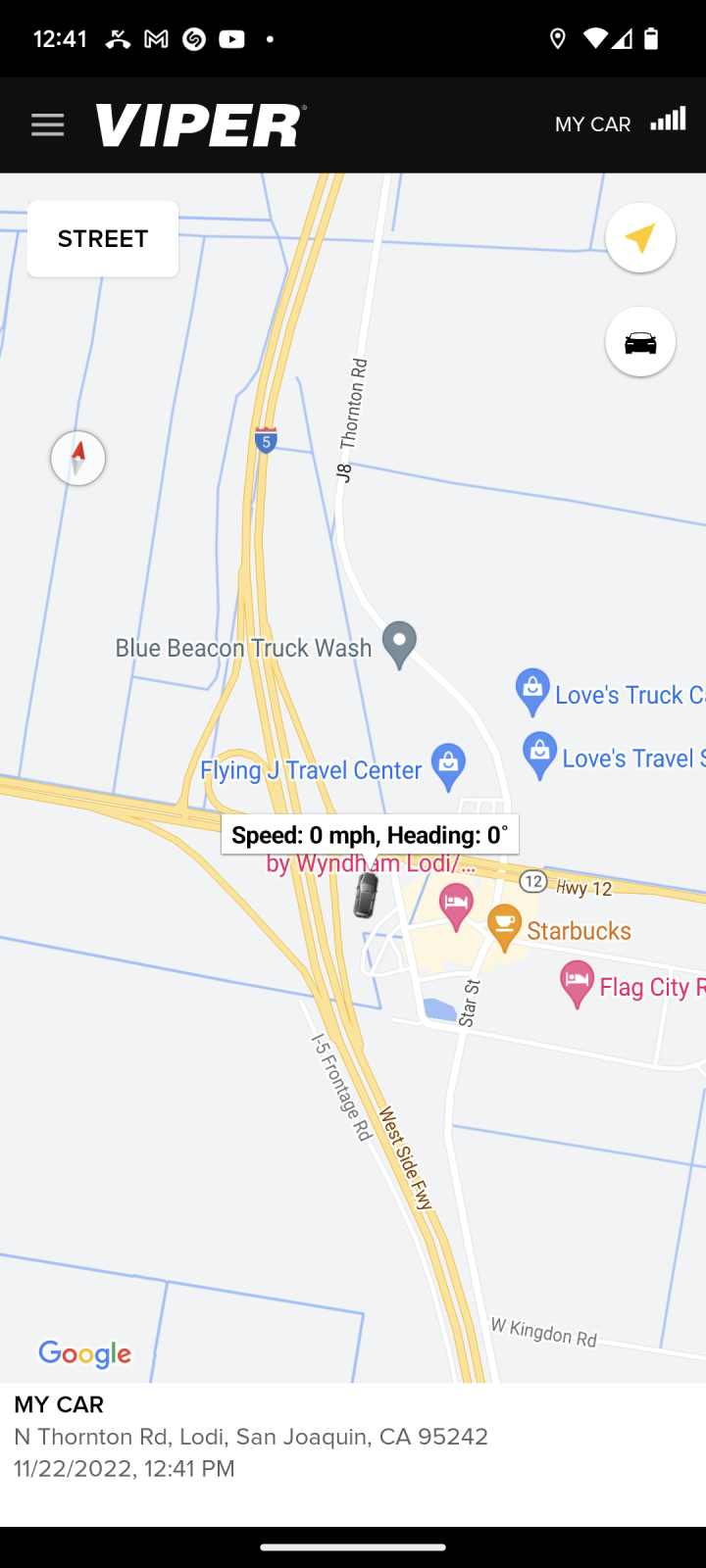

I know where mine are at all times, location can be updated every second, yes it can be disabled but not if you don't know it's there and are not looking for it and it's buried way up under the dash

the gps/smart start is a separate module, it works with a variety of directed alarms, in fact if you get the directed "brand" smart start it is cheaper than the the "viper" the kicker is they are the exact same thing you are just paying extra for the viper sticker on it.
the viper is the vsm550
the directed is the dsm550
they are electronically identical and work on any supported directed alarm brand. clifford, avital, viper, etc..
you can install it yourself it is plug-n-play no programming needed, you just have to pay for the service which is annually about $120 so $10-12 a month
which model did you have installed? pretty much if it has remote start then the dsm550 will work, you just plug it in the correct port and then connect constant power and make your account online. then you can do all your remote functions and track it with your phone, tablet, pc, ipad whatever.
you can use the viper app or the directed app whichever one you prefer, I like the viper app myself
the module just goes under the dash, you want it up high so it will get a good signal it will show which side goes up.
the module has a imei number just like a cell phone or hotspot (you will need that number to activate it, it's on the device and on the box it comes in)
you can have multiple vehicles on the app also, not sure how many it supports I have 3 on it
